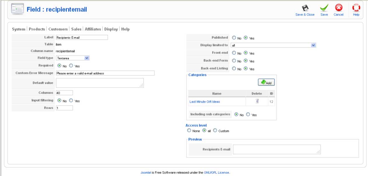

Could you do a screenshot of your custom field's options screen ?
Also, please activate the debug mode in the configuration of joomla and try again. If you get an error message that time, please paste it here. That would help us understand why it's not working.
  • Posts: 6
12 years 11 months ago #33716
Attached is a screen shot. Thanks so much! Also, the recpients email does not show up on the orders page, but our other custom field does. I attached the orders page as well.
