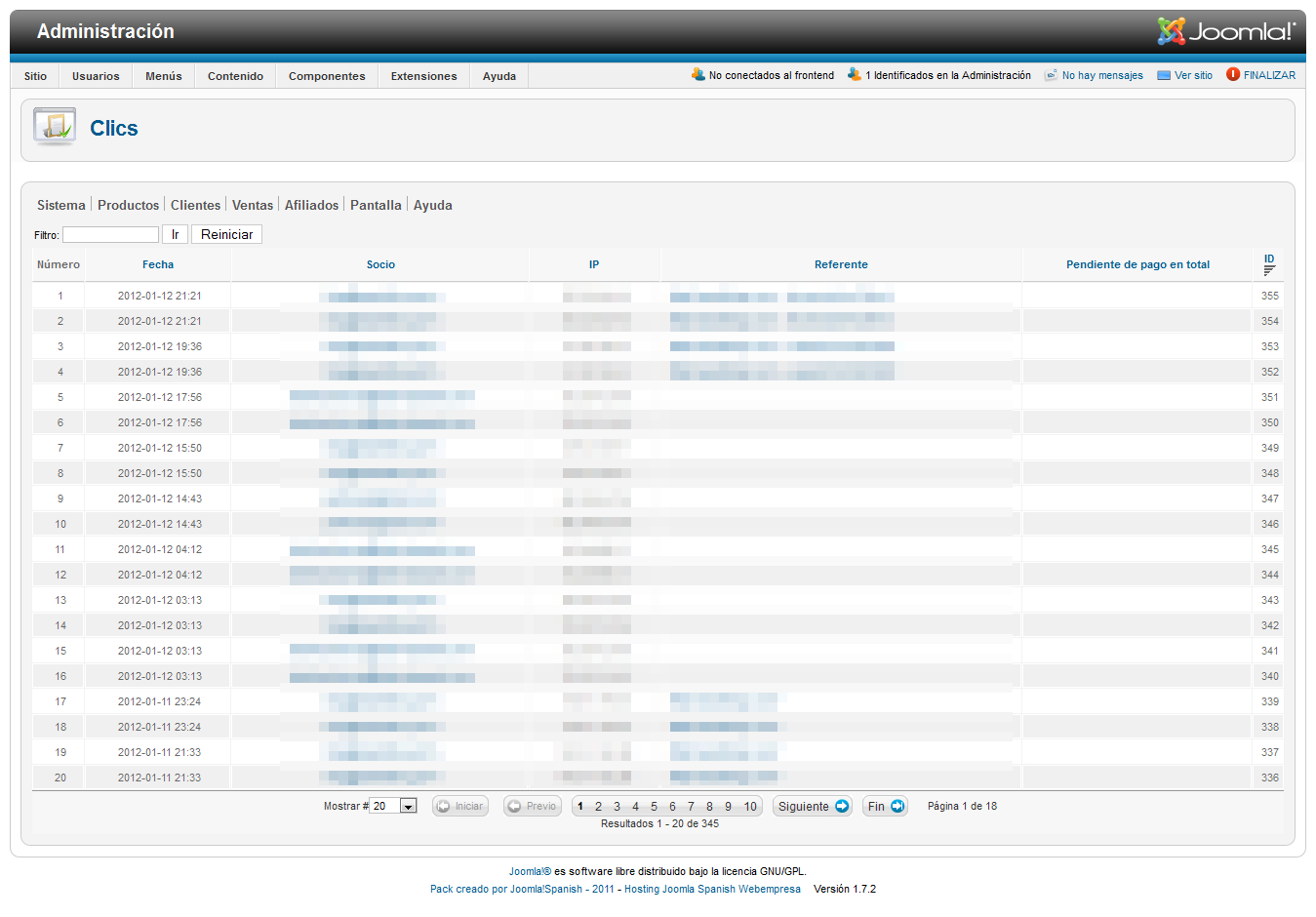

In the affiliate section, all the clicks appear twice.
You can see it on the image attached.
Some idea why does it happen? and how can it be solved?

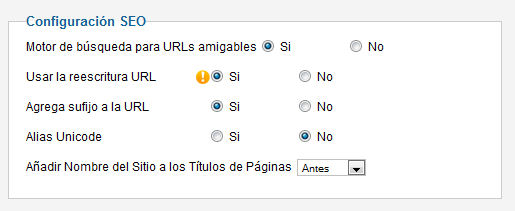

Do you use a specific SEF extension ?
I use the default joomla 1.7 sefurl. (see image attached)
Can it happen because my site work without "www"? I don't think but I have no idea why does it happen.
