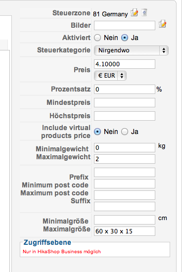

12 years 10 months ago #35523
Then please do a screenshot of your shipping method configuration and give a link to your shop so that we can see what you did as it is a configuration issue on your end (it works for everyone else).
  • Posts: 4
12 years 10 months ago #35625
please find the screenshot attached.
The shop is not yet public, I will send you the url and a login via PN.
Big Thanks!
