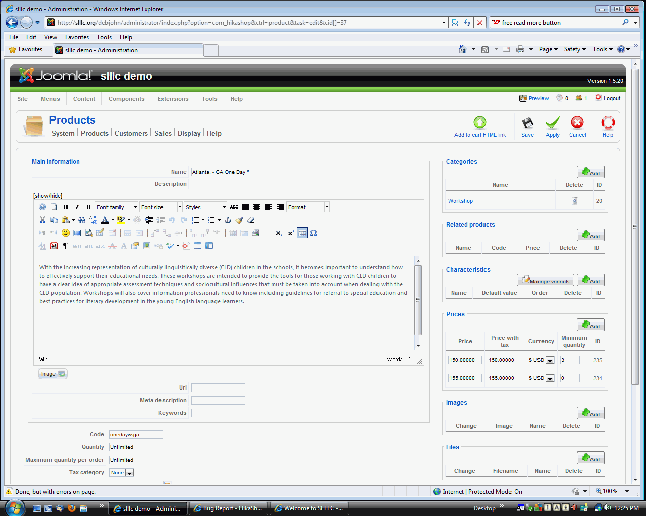

when I click on the add image button on product right panel receive "done but with errors on page"
i.e. does not show dropdown to install an image.
also, cannot remove default image from system-config

Q1
image attached
the only "add" tab a right that works is the "prices"
  • Posts: 82868
  • Thank you received: 13376
13 years 11 months ago #3753
That was a bug in an old version of HikaShop. Do you use the latest version ? If not please update. That was a bug with Internet explorer not supporting some of the JS we were using. Since then, we changed the way we do it to avoid the problem.

I am using IE-8, did not have prob until upgraded to version 1.40 of HikaShop
While I was waiting for your reply, I tried with Firefox and the pop-up screens appeared when clicking on the "add" button(s) what I wanted to perform worked using Firfox
Whent back to IE, tried changes to pop-up settings in IE, did not resolve the pop-up window not showing when clicking on the "add" button(s)

If you try the same operation on our demo website, do you get the same behavior ?
It works for us on our demo website with IE8 so it should work for you as well. If it don't, that means that it's a problem of settings in your IE. If it does work on the demo website, it means that the problem is on the backend of your website. Maybe you have a special plugin/module which breaks something. Like for example if you get a warning on your backend because of an error in another plugin, it can mess up the headers in IE.

tried the same operation on your demo website, and I do get the same behavior
will have to research IE for which setting(s) may be the prob
p.s. did find a post about Post about IE and JS corruption posibility, they recommend reinstall if IE
For now will workaround by using firefox, as I have a deadline, will get back with my findings later
