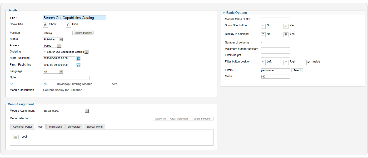

I am having a problem with the filter module. I have setup everything according to the steps on how to use the Filter Module. It works on the catalog page but when I use it as a module in another page, it does not work. Please take a look shoxwebdesign.com/aero/capabilities - Here it doesn't work, it refreshes the page with no result. IN this one it works perfectly shoxwebdesign.com/aero/capabilities/catalog -
I have attached a screenshot of my joomla module preferences - thanks for your help.
