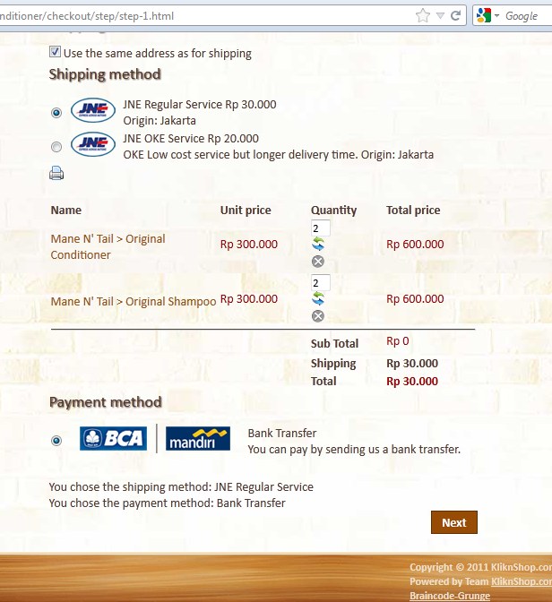

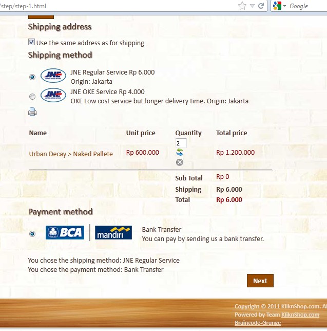

i have used hikashop starter for one year and never found this until just now. This is a case in calculation of invoice in checkout process.
case:
-if products are totaled for 1.200.000, then the calculation for 'sub total' is 0

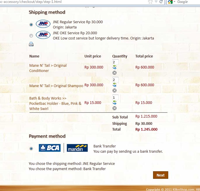

-if products are totaled for other than 1.200.000, then the calculation for 'sub total' is working fine
-i have tried different products combination to recreate the case, and yes they do recreate the case.
-im not sure whether there is other number that will make 'sub total' to 0
i attached screenshots for better understanding
Any idea how to fix this??

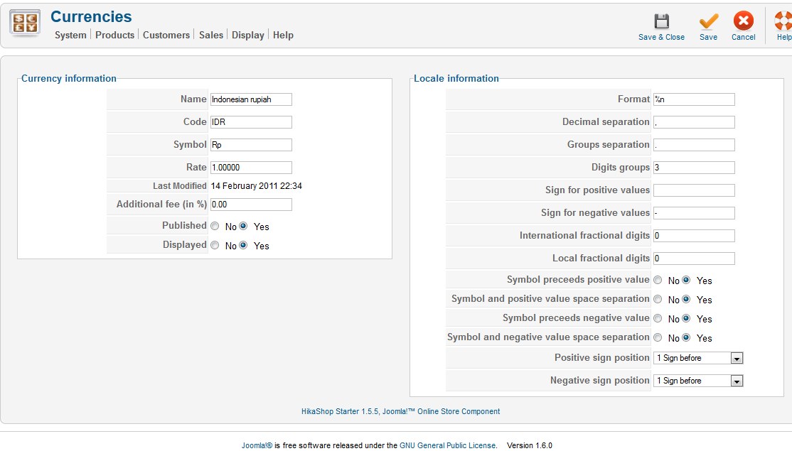

  • Posts: 82863
  • Thank you received: 13372
12 years 9 months ago #40322
I posted the solution which worked for me:
www.hikashop.com/forum/3-bug-report/3928...m.html?lang=en#40262
