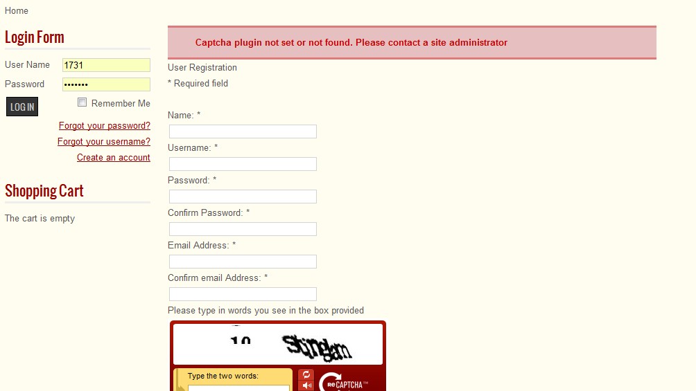

I was getting the following error when using the reCaptcha plug-in for the joomla user registration page. I get the following error even though the reCaptcha text box is displayed .
Captcha plugin not set or not found. Please contact a site administrator
This is followed by a fatal error when I complete the registration form, the reCaptcha and submit.
Fatal error: Call to a member function checkAnswer() on a non-object in /html/erielack/test-dev/joomla/libraries/cms/form/rule/captcha.php on line 47
I had the J 2.5 reCaptcha plug selected in the global configuration but I had the plugin unpublished. I just set it to not selected in the global configuration and published both the Joomla and HikaShop captcha plugs. This cleared the error and it appears captcha is now working. Is this the correct configuration?

12 years 7 months ago #62462
Nicoles,
I understand that I need to use the Hikashop Recaptcha plugin and that is what I have done in my test environment however I still get a captcha not set error as pictured below.
By the way, I am running Joomla 2.5.6 and HikaShop 1.5.8 now.

  • Posts: 83604
  • Thank you received: 13536
12 years 7 months ago #62469
That error doesn't come from HikaShop.
It comes from the Captcha library of Joomla 2.5. It means that you still have some captcha stuff turned on in Joomla:
forum.joomla.org/viewtopic.php?f=628&t=715047

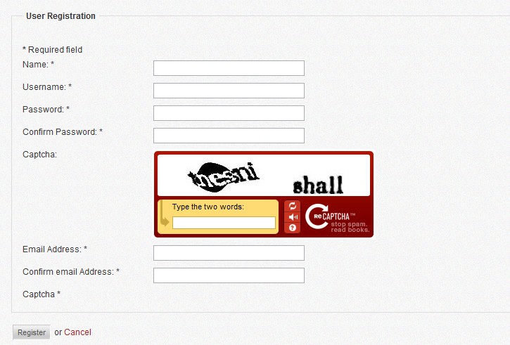

  • Posts: 45
12 years 7 months ago #62534
Nicolas,
The last post in the forum thread solved the problem. I did not realize there were several locations in Joomla 2.5 to setup the system captcha. I selected "Not selected" in the Global Configuration, User Manager options, and Contact options forms tab and it is now working. You may want to add this bit to the HikaShop captcha configuration documentation.
Thank you,
Paul

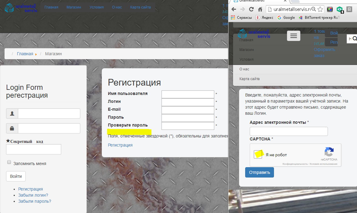

  • Posts: 68
9 years 1 month ago #233943
Sorry recaptcha works everywhere except hikashop!!!!!!!!! Present in (Forgot password) (Forgotten login) only in the menu hikashop registration no. Why? Where in hikashop to configure to connect to recaptcha? Thanks in advance sincerely konuzelev!!!!!!!!!!!!!!!
Извините recaptcha везде работает кроме hikashop!!!!!!!!! Присутствует в (Забыли пароль) присутствует (Забыли логин) только в меню регистрации hikashop нет. Почему? Где в hikashop настроить подключить recaptcha? Заранее спасибо с уважением konuzelev!!!!!!!!!!!!!!!
  • Posts: 83604
9 years 1 month ago #233946
The Joomla Captcha plugin isn't made to work with HikaShop.
Please use the ReCaptcha plugin we provide on our website:
www.hikashop.com/support/documentation/7...-with-recaptcha.html
