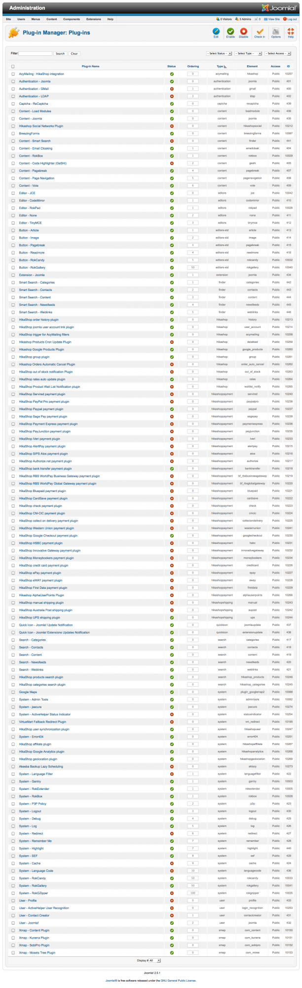

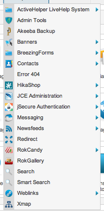

12 years 8 months ago #41165
here are screen captures of what is installed
  • Posts: 82863
  • Thank you received: 13372
12 years 8 months ago #41329
I don't see any extension standing it in your screenshot.
What would be the system plugins that you don't have installed on your other website ?
If you unpublish them, does it work better ?
What a re the SEF and non SEF links of the address edition iframe (you can use firebug to get that information once the popup is openned)?
