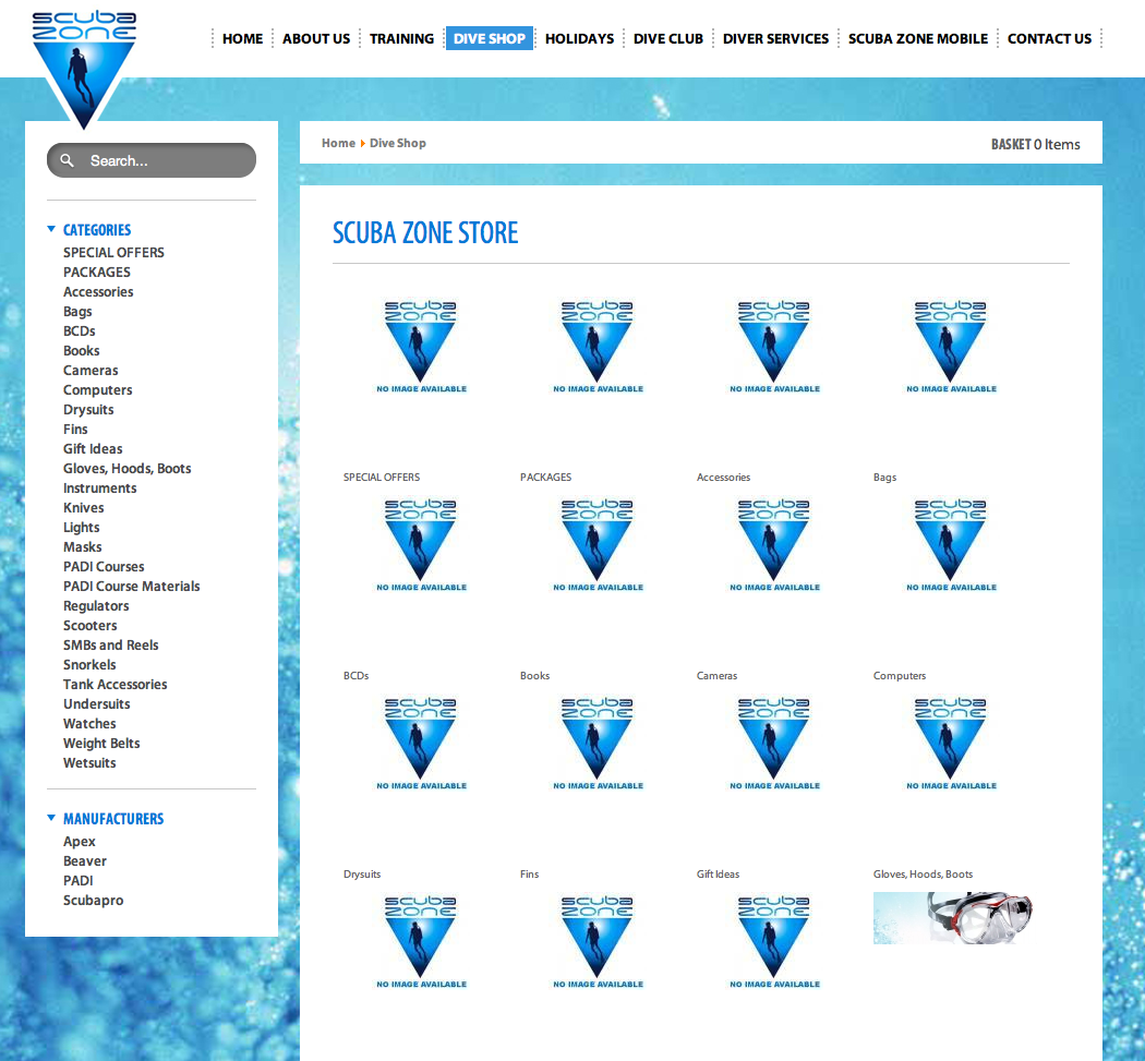

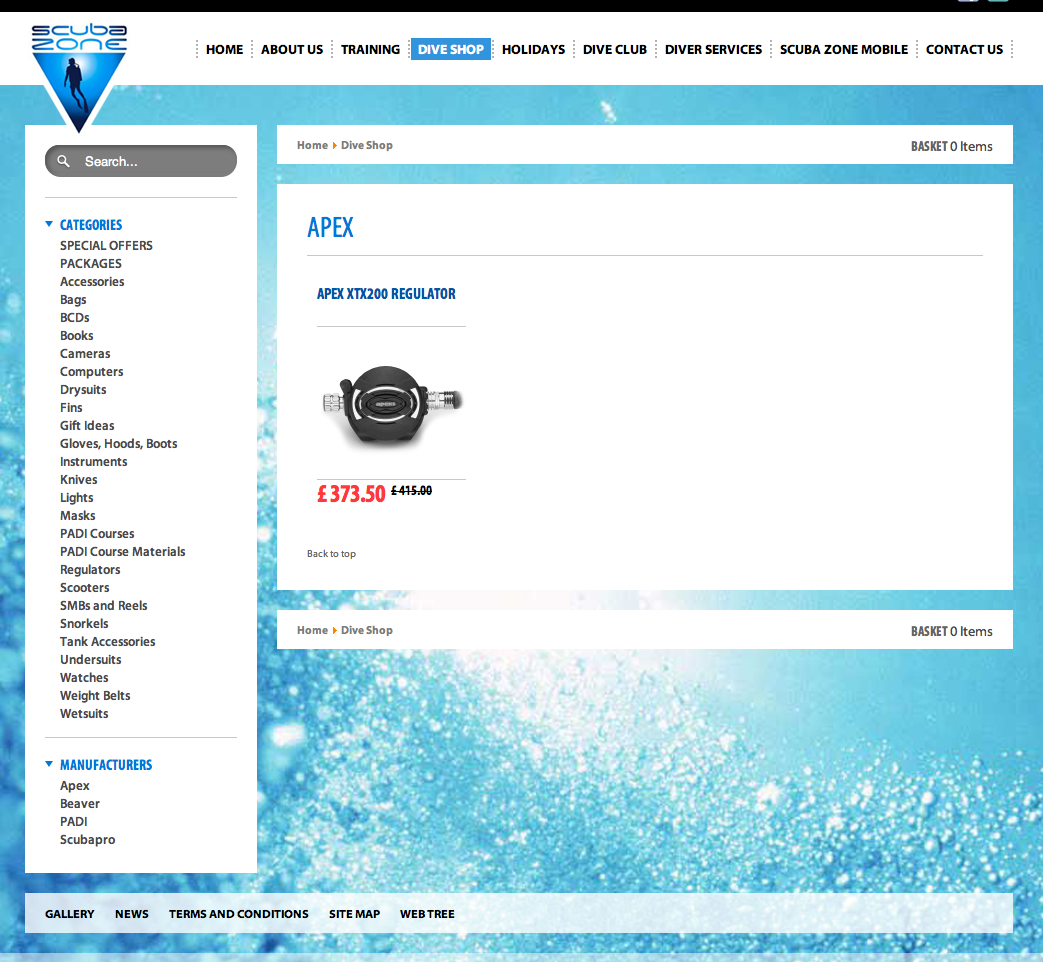

I have a really odd thing happening to my manufacturers menu > products display, after upgrading from free to business.
It all worked fine in starter, so if you clicked a manufacturer in the left menu it displayed all the products in the main component by that manufacturer. But after the upgrade to Business it just list does a category list page instead. I have tried scrapping the Manuf menu and creating from scratch but I can not get the same result as I did in starter.
I tried to repeat the process in starter and it works fine, so I can only guess this is an issue or bug with business, or something new in business that I am missing.
This is a dev site, I can send you links privately if you like. I have attached 2 screen shots, bot of which are reached by clicking Apex in the manuf menu. 1 is in starter, 2 is in business.

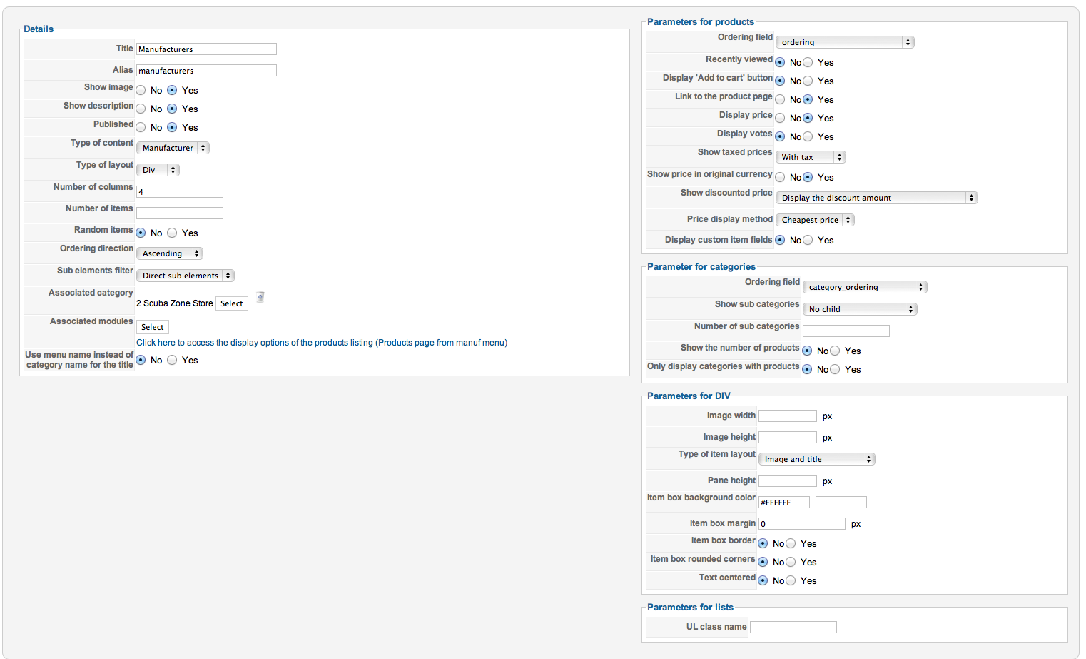

They must be configured differently. The Starter and Business edition work the same.
Could you do a screenshot of the hikashop options of your apex menu ?

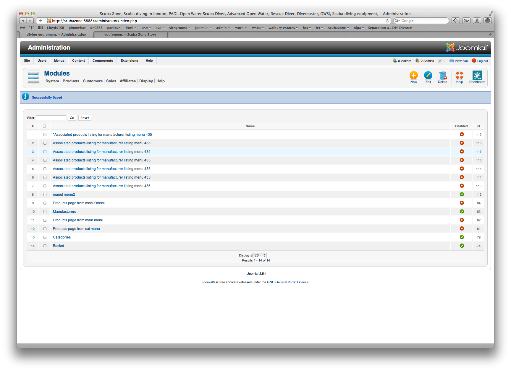

12 years 11 months ago #48708
Very strange things...

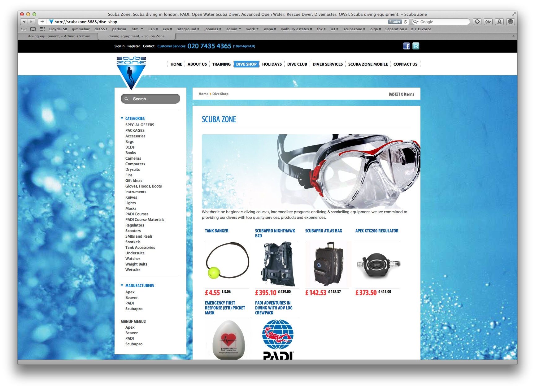

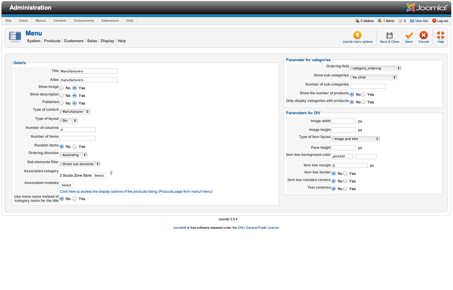

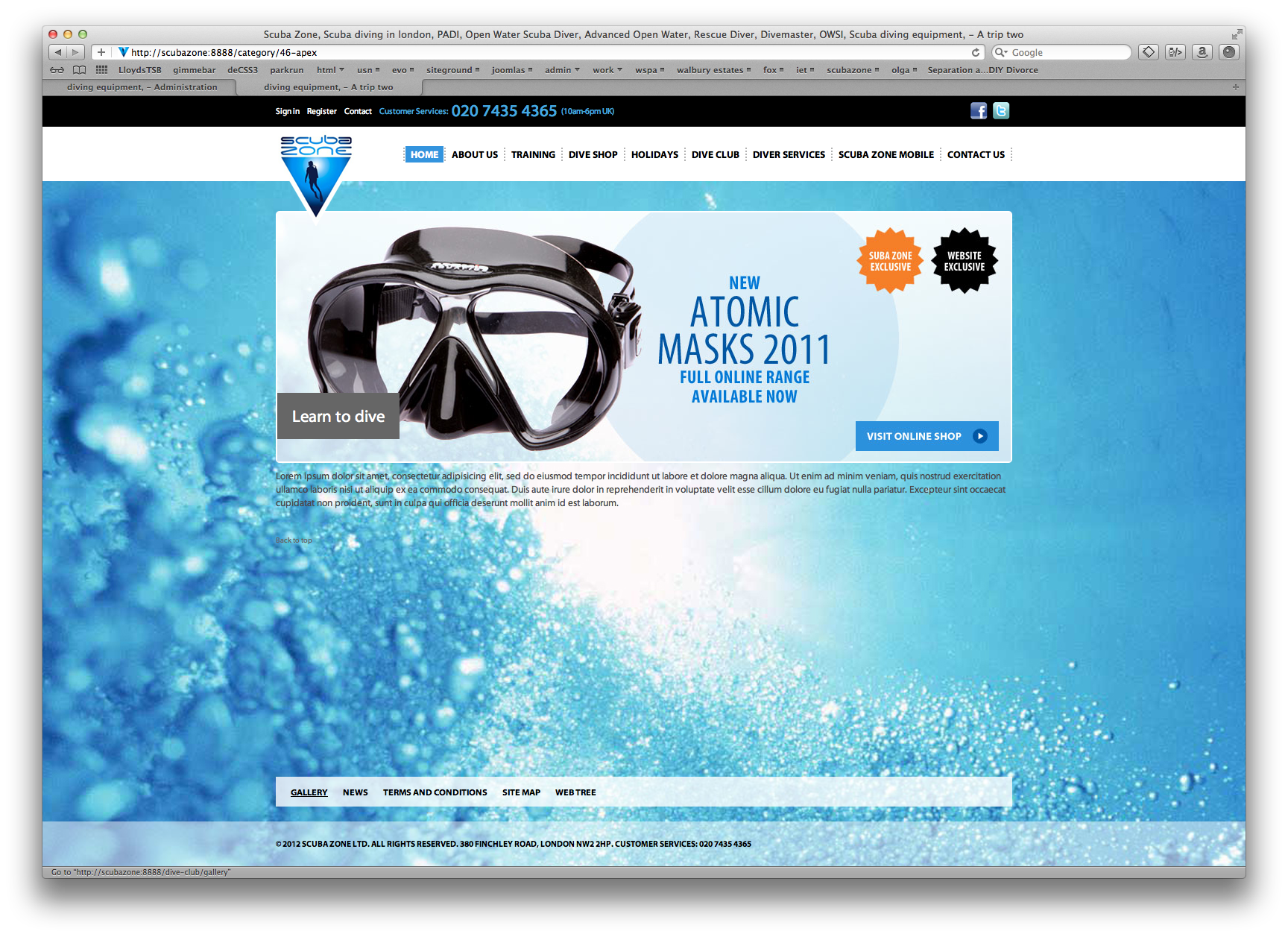

I create a new hike module, assign to left position, change hika options to manufacturer, list, 1 col etc, save, and it seems to create multiple associated modules (screenshot1) on each save.
I get the menu ok (screenshot2), but when clicked it takes me to a weird semi version of the homepage.(ss3)
Sorry, maybe I'm just doing something wrong, but I don't think so. I wouldn't have thought anything like this should happen just from upgrading the install.

It's just a matter of setting up the module as explained in the documentation. There is no reason it wouldn't work. From what I can see of your screenshots, the "menu" option of your module is not configured properly with a category listing menu.
