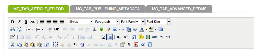

Also in the backend after installing the plugin it changed all the descriptions and added extra text in displayed tabs (see attachment!

Regarding your screenshot, that is not something coming from HikaShop. I don't know what that is or why it would display like that.
