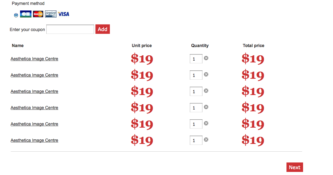

I have just upgraded my dev environment to the latest business version 1.5.7 and am now experiencing a problem at the checkout.
When a user logs in to purchase a product, at the confirm screen - clicking next does not proceed them to the next step it simply adds another duplicate product and gets stuck there.
Any idea why this would happen?
Our settings should be only to ever have 1 item in the cart. I don't see how that would affect this though.
Please have a look at my dev environment dev.bellabuy.com.au
I have also attached screenshot of what is happening.
Thank you in advance.
Jac

12 years 11 months ago #51460
Please turn on the "debug mode" option of the joomla configuration and try again.
That will probably display a MySQL error because some columns in the database are missing:
www.hikashop.com/en/support/documentatio...lity-issues.html#SQL

12 years 11 months ago #51900
I just checked your website.
It comes from a customization of the file "cart" of the view "checkout" that was done via the menu Displa>Views. Removing the customization solves the problem.
Regarding your "token valid" error, it has nothing to do with HikaShop, so updating HikaShop won't solve it.

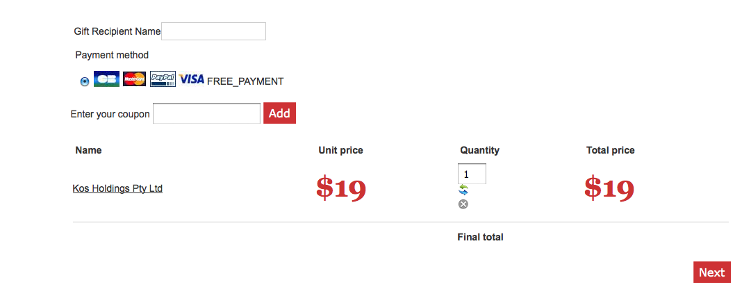

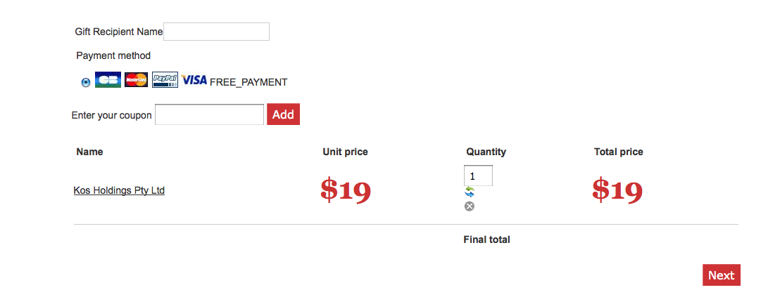

I have now upgraded my production website and just have a couple of small issues I'm trying to resolve and wondered if you could please help?
1 - FREE_PRODUCT text on checkout, how can I remove this?
2 - Refresh button under quantity - can I remove this?
3 - Final Total text - can I also hide this as well without messing things up?
Screenshot attached.

  • Posts: 83674
  • Thank you received: 13545
12 years 10 months ago #52221
That's because you're missing the new translation key FREE_PAYMENT in your translation file.
Just add it via the Languages tab of the configuration.
You can remove the refresh button with that CSS:
.hikashop_cart_product_quantity_refresh{display:none;}
You can remove the Final total text with that CSS:
#hikashop_checkout_cart_final_total_title{display:none;}

  • Posts: 83674
12 years 10 months ago #52333
In the front end CSS file of HikaShop that you can edit via the Display tab of the configuation.

  • Posts: 83674
12 years 10 months ago #52584
You actually broke the class attribute of the HTML by adding that CSS in your view file...
Because of that the same CSS code that you added in the CSS file of HikaShop cannot work.
You will have to edit the file 'cart' of the view "checkout" and revert the modification you did there.

  • Posts: 83674
12 years 10 months ago #52671
It works. I can't see anymore the elements on your website and I can see that the CSS is in the CSS file of HikaShop.
Just refresh your browser's cache and you will see it too...
