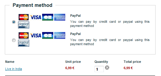

In the payment method choice in the progress, there is 2 paypal choices.
Why?

13 years 10 months ago #5298
Good question. That's the first time someone reports such issue.
Could you look in the joomla plugin manager in the group hikashoppayment and see if you have twice the payment plugin ? If so could you unpublish one of the two ?
Same in the menu System->Payment methods, you should only have it published once there.

13 years 10 months ago #5299
There is published 1 in Joomla plugin manager.
And 1 published in the Hikashop payment plugin manager.

13 years 10 months ago #5300
Could you look at the entries in the table jos_hikashop_payment in your database and check that you have only one entry in there for the plugin paypal ? If not, delete one and try again.
If all that is unsuccessful, try to empty that table, uninstall the hikashop payment plugins, reinstall hikashop and reconfigure your paypal plugin. That should hopefully solve the problem.

13 years 10 months ago #5301
That solved it, it also solved the missing Paypal button in the Redirect window.
Thanks!
I tried the solution by deleting 1 one the Jos_paypal tables in MyPHPadmin.
