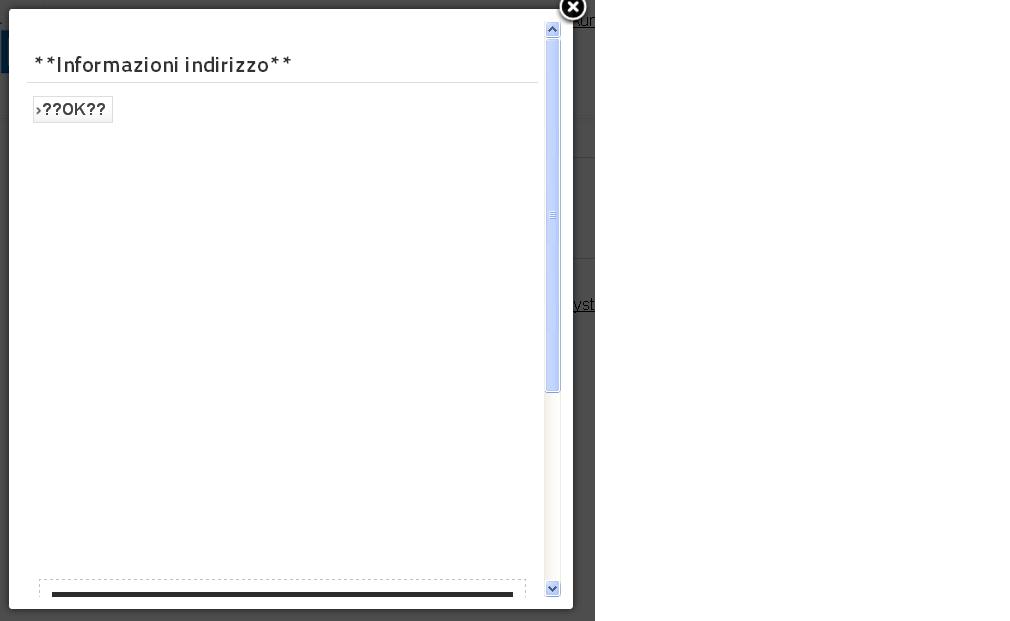

Hello, i have installed joomla 2.5.4 and hikashop 1.5.8 version for a test and decide which product use for my new shop on line. the hika is very nice but the form address is blank. can you help me? thanks

12 years 10 months ago #53608
hi, i have the same problem of this discussion
www.hikashop.com/en/forum/3-bug-report/5...pup-not-working.html
i attach one picture
thanks
i have this problem with any browser

  • Posts: 10
12 years 10 months ago #53783
hi,in display--Custom fields menu i don't see anytingh (see attach, thanks)

  • Posts: 10
12 years 10 months ago #53791
the query
SELECT *
FROM ta_hikashop_field as a
WHERE a.`field_published` = 1
AND a.`field_backend` = 1
AND a.field_namekey!='address_name'
AND a.field_table='address'
ORDER BY a.`field_ordering` ASC
return 0 result
  • Posts: 83603
  • Thank you received: 13533
12 years 10 months ago #53865
Download and install again HikaShop and that should solve the problem.
The following user(s) said Thank You: liberoc
  • Posts: 10
12 years 10 months ago #53933
thanks, now go!
