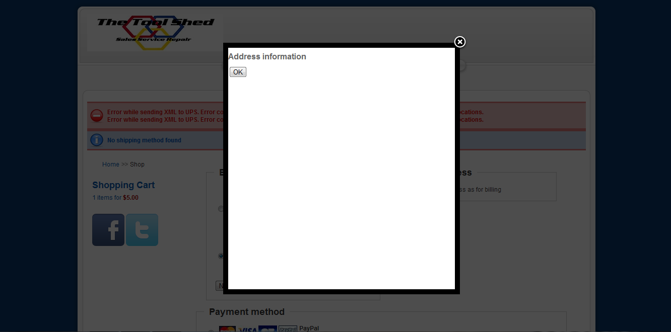

I'm loving Hikashop! Its the first shopping cart I've been able to get working on my joomla site.
I am having one issue which I can not find a solution for. When the customer would click the button to edit their address, the popup is blank. So there is no way to enter a shipping or billing address.
My website is gvtoolshed.com
I've tried both internet explorer and google chrome with the same issue.

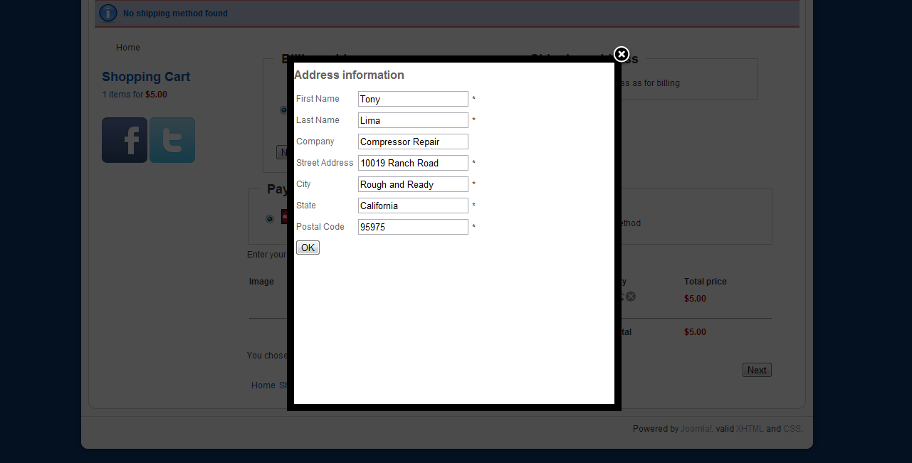

Ok so I was able to solve my problem by changing the custom fields in of the address.

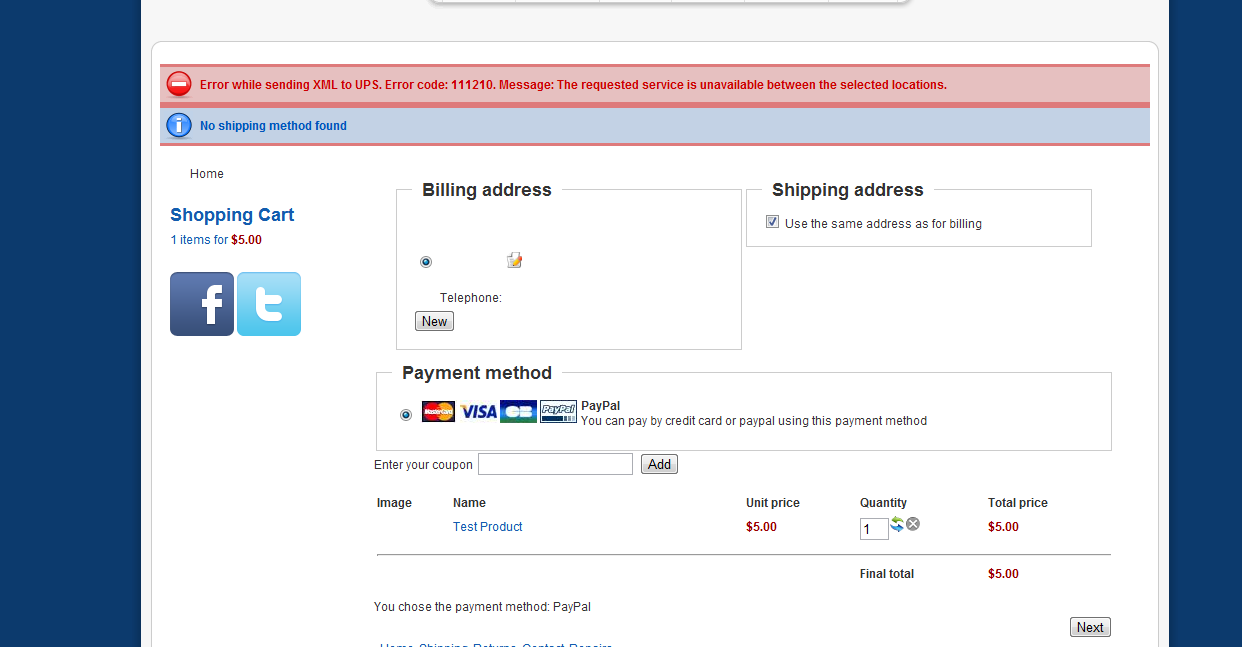

Now the customer can fill out their address but when they click ok to save the address, it is not displayed on the check out screen.
Included are the screen shots of my problem.

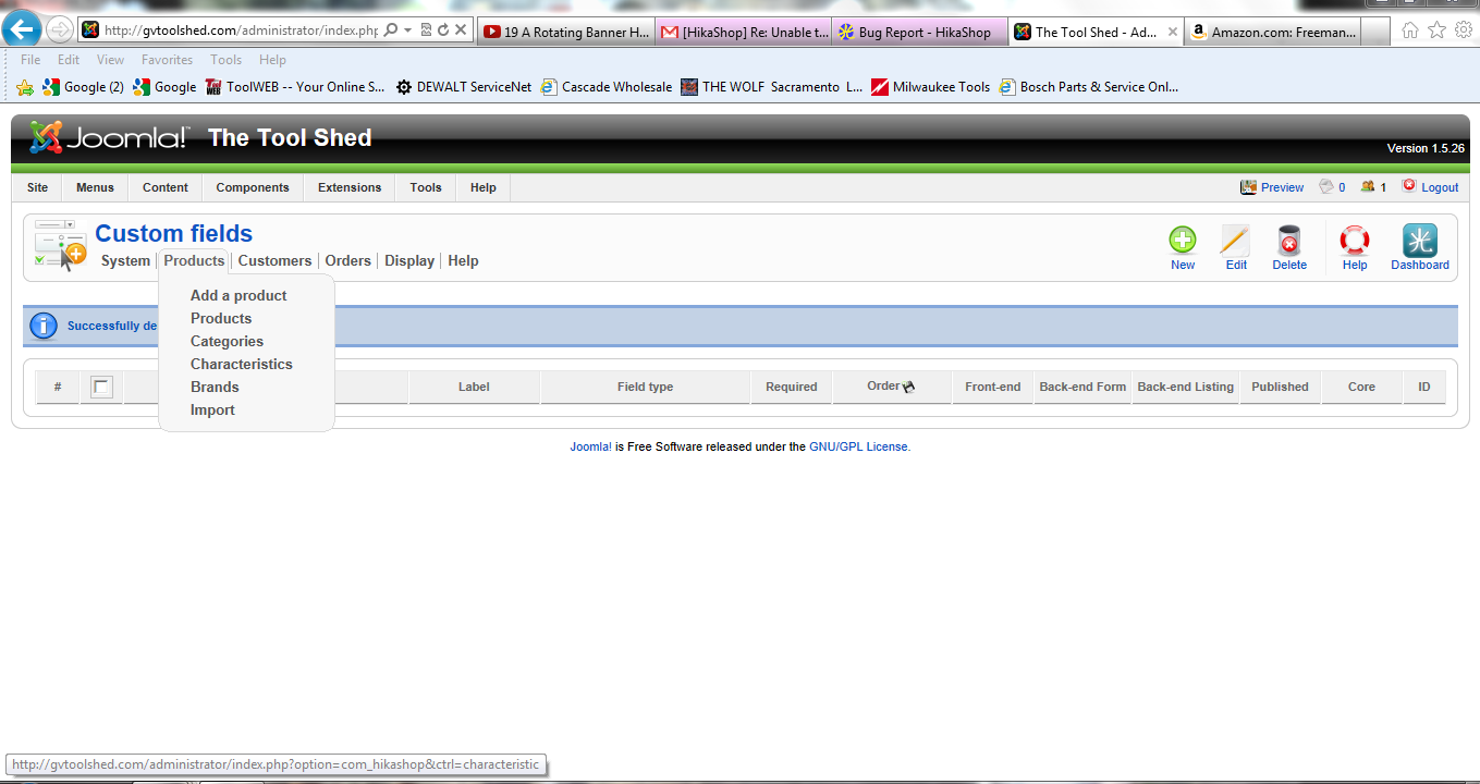

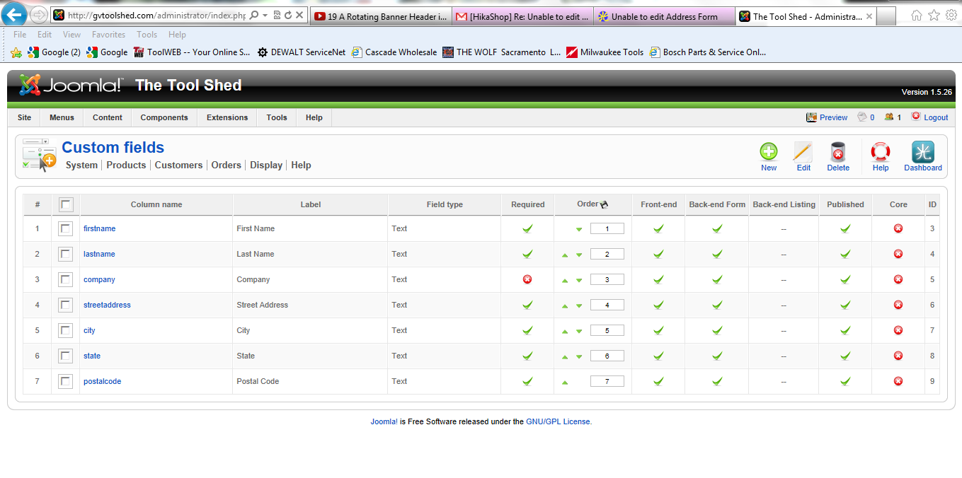

I see that makes sense. When I went into custom fields originally there were no default fields. Maybe I deleted them? I dont think I did though. Any how, is there any way to restore the default fields.
Here is a screen shot of my custome fields with my changes and after I deleted them.
Thank you so much for your help!
  • Posts: 10
12 years 10 months ago #53294
woops screenshots didnt get attached. Here they are

  • Posts: 83604
  • Thank you received: 13535
12 years 10 months ago #53303
You should delete them all. Then, download again hikashop on our website and install it on yours. That should put back all the custom fields.
