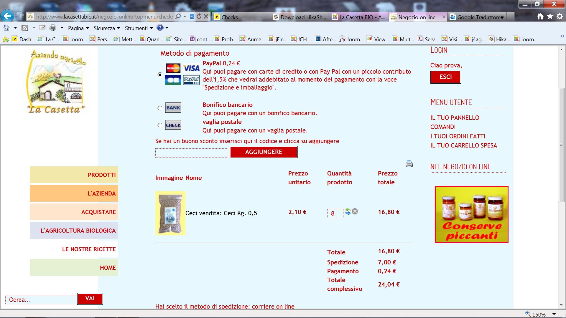

Here is a screenshot. I set the percentage on 1.5%.
The system give me Euro 0,24. It should be Euro 0,36 (16,80+7=23,80 * 1.5%= 0.36)

12 years 10 months ago #53789
Ok, I checked and there is indeed a problem with the payment fees, but it's not a problem with taxes. It's just that it rounds the percentage before applying it.
You can download and install again HikaShop to fix the problem.

12 years 10 months ago #53810
I Updated it.
Now the amount near the PayPal choise is correct.
But there are always the same problem with the total below.
