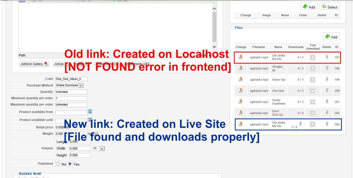

Hi.
I am having the "File not found" error on my downloadable products.
The links work fine on the offline localhost but when I tried them online, I keep getting "File not found".
I tried troubleshooting and noticed the download links only worked when I re-created them online (no editing or change of config. Just add new file > use the same path as the files returning "File not found" > change the file name) and voila! it works.
Also if I used the same file name as the old one to create the new download links, I get the same "File not found" error on such links.
Is there anything that can be done to fix this. The products are over 100 and variants too, so manually recreating each download link is going to be a very daunting task. I also tried checking the database for clues but no luck.

11 years 7 months ago #121328
Hi. Thanks for your response.
Before I begin, there is a part I forgot to add in my initial post.
.1) The download links work fine for products that have their files attached directly to them. (i.e. Products with no variant)
.2) The download links return "File not found" on products that have their files attached on their variant. (Some products have two variants: Shipped and Online Download)
That being said I am 100% sure I already have the configurations and file locations correct.
The only different thing was the file permissions you suggested. I have (604 on files and 705 on folders). But the download links work fine with these configuration for products without variants.
Nevertheless, I still modified the file permissions to 664 and folders to 775 but the error still persists.
So I think the issue is from how the variant is configured BUT still, every new file I added to a variant downloaded fine.
Its the old links (which have the same configuration and file locations as the new ones) I am having issues with

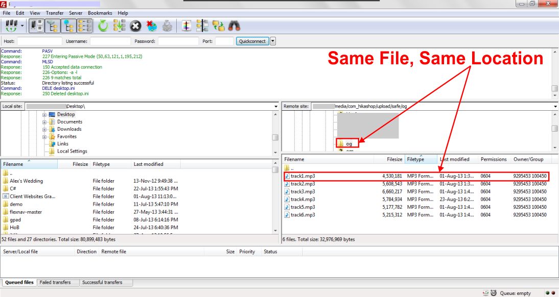

  • Posts: 10
11 years 6 months ago #125151
Hi. Were you able to view the code.
I am sure I have done everything properly.
Please view the snapshots below.
.1) The same file in the same location as at when it was uploaded
.2) The links and filenames are the same, only that the links created on the localhost don't work.
I believe the bug should be fixable rather than having to recreate all the links all over again.
Thanks for your time.
