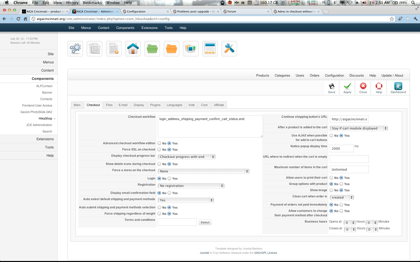

So everything HAD been working fine, processed a number of transactions, however I wanted to be able to bypass registration so I went ahead and purchased the upgrade. After installing I've now experienced a number of problems that I'm hoping can be resolved.
For a brief period of time the login/reg page was not appearing, however on the payment page there were no fields for entering credit card info. Authorize.net is our only payment method and it seems to be defaulting to that properly but theres no way for anyone to enter info.
_Now_, despite having the login and registration options turned off in the Configuration tab I'm still being presented with the login/registration page. Additionally there are no fields for entering credit card info in the payment section. As I mentioned, this worked prior to upgrade and I need to go live with this so I'm sort of stuck.
This is a fairly simple setup with basic pricing, no discounts or coupons, flat rate shipping, one payment method and thats about it, so I'm hoping you might have some advice on how I can make this work. I've tried a number of workflows, all to no avail. Screenshot of current config tab attached. Site can be viewed at aigacincinnati.org/site/index.php?option...t=listing&Itemid=248

The "no registration" option remove the username/password fields from the form of the checkout and does not create a user account for them. It still allows users to enter their address.
That's kind of a requirement if you want to ship the goods to your users...
Nevertheless, if you don't want any address information from your users, you can remove the login and the address views from the checkout workflow option. Your users won't see that form at all.
If you're confused because the text still says "register", you can change the text via translation overrides:
www.hikashop.com/en/download/languages.html#modify
