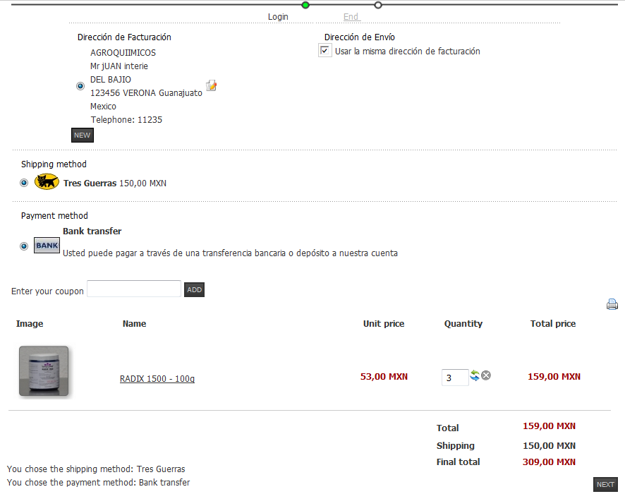

I'm using Joomla 1.5.25 and I installed hikashop see. Version 1.5.8 noncommercial and I have the following problem.
After pressing the button below, once you agree to the terms of purchase, I again see the same page.
I can not get confirmation of purchase.
I have enabled the option to purchase up appears login and end, when I press end is the same.
I have enclosed a copy of the screen thank you very much

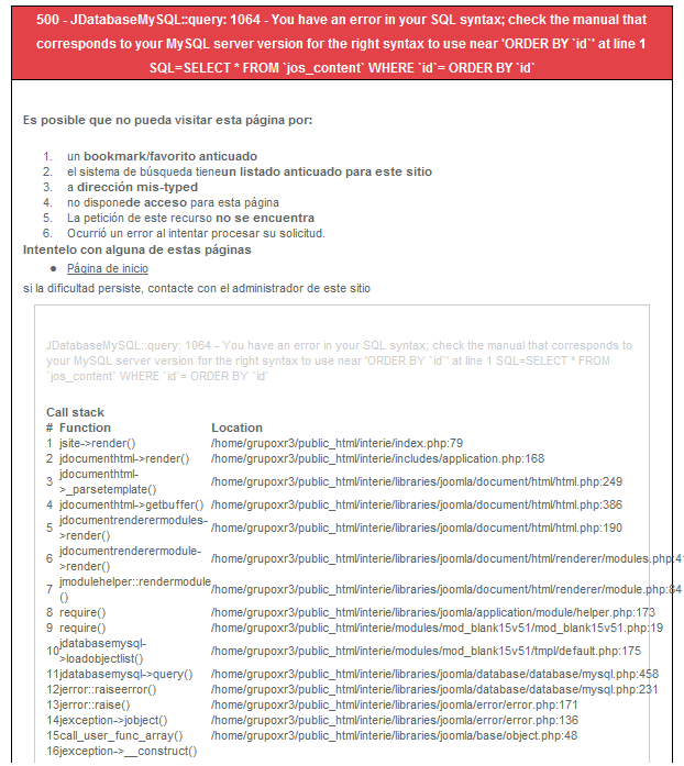

I put debug mode joompla and sent me a series of mistakes, I am sending the screen capture

That error comes from the mod_blank15v51 module that you're using. Could you unpublish it and try again the same thing so that we can see if you have an error an the end of the checkout ?

In the screenshot of the page I send you a syntax error: line 1 ORDER BY.

The debug mode is turned off on your website, so we can't look at the problem.
The syntax error comes from the mod_blank15v51 module. It is something else and it's not related to that problem.

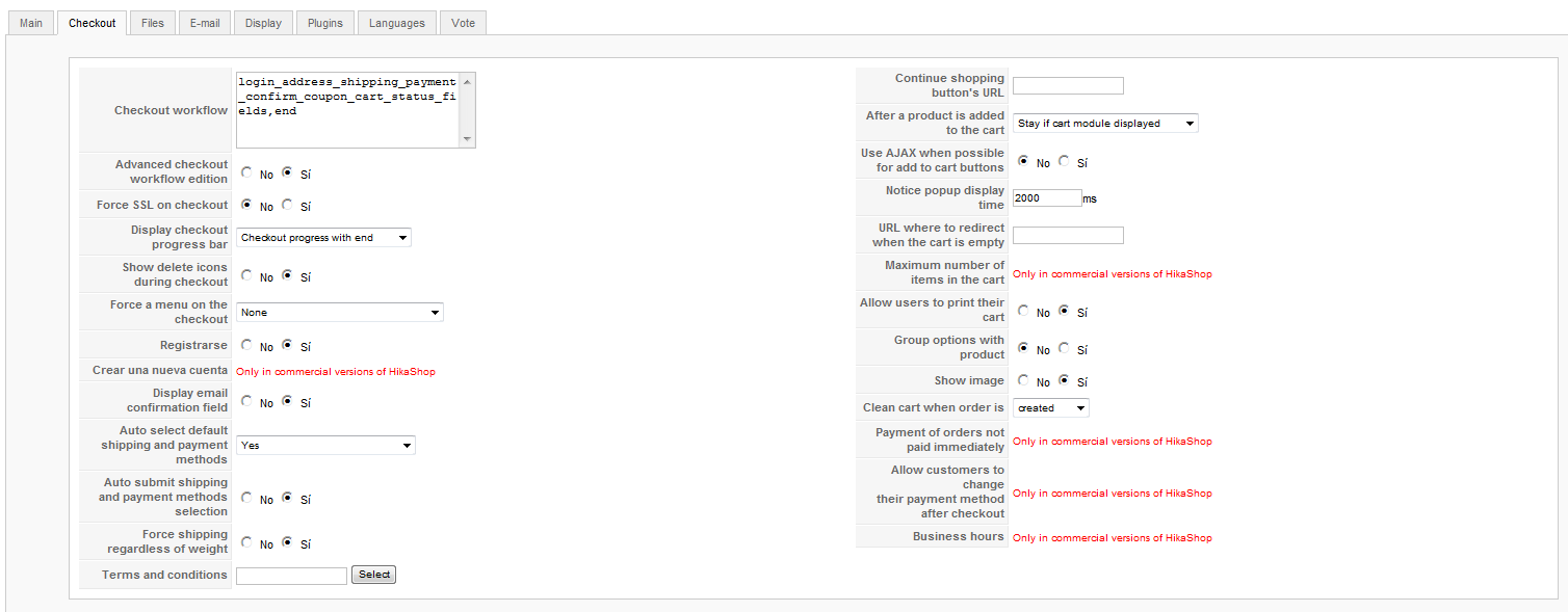

Please do a screenshot of the Checkout tab of the configuration so that we can see how you configured your checkout.

I Send you the screenshot of the checkout tab of the configuration from my site.

You're apparently on PHP4 that it leads to that problem. I strongly advise you to ask your hosting company to use PHP5. PHP4 has been unsupported for more than a year now and could have security issues. Normally, they should be able to do that without too much trouble and it will solve that problem at the same time I think.
If they can't do it, you can try to change the line:
<input type="hidden" name="unique_id" value="[<?php echo md5(uniqid())?>]"/>
to:
<input type="hidden" name="unique_id" value="[<?php echo md5(uniqid('hika_'))?>]"/>
in the file "step" of the view "checkout" via the menu Display->Views.
