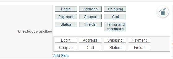

I have a similar error. I've tried what you suggested, but I get this message:
Your checkout workflow is empty.
Checkout workflow invalid. The modification is ignored. See the documentation for more information on how to configure that option
No valid weight unit entered. The system put back the default units.
No valid dimension unit entered. The system put back the default units.
Successfully Saved
The workflow area doesn't look empty and it won't let me put the "advanced checkout workflow" option to "no".
I get the same message when I try to adjust the tax zone and such.

12 years 8 months ago #59138
That's a problem between your user session and your browser's cookies/cache.
Try with another browser or clean your browser's cache/cookies and you will be able to change the configuration.
  • Posts: 7
12 years 8 months ago #59180
Okay, I did that and now I'm able to save changes. :) Thanks!
