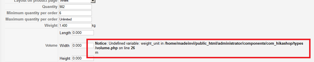

I found an error on the product page
Notice: Undefined variable: weight_unit in /home/madeinvi/public_html/administrator/components/com_hikashop/types/volume.php on line 26
I am pretty sure this error was not present yesterday.
Today I worked on my website but I didn't install any new extensions
Do you know what is the reason?
(PS: if you want I can send you the URL, username and password)
*** UPDATE *** I discoverd the reason. In Joomla I setted the Error Reporting at "Maximum". If you use "System Default" there isn't any message.
The question is, is it normal this behaviour?

This problem would be solve in the next release of HikaShop.
You can manually fix this problem by modify the line 26 in the file administrator/components/com_hikashop/types/volume.php
[code type=php-brief]return $volume_unit.'<input type="hidden" name="'.$map.'" value="'.$weight_unit.'" />';[/code]To :
[code type=php-brief]return $volume_unit.'<input type="hidden" name="'.$map.'" value="'.$volume_unit.'" />';[/code]
