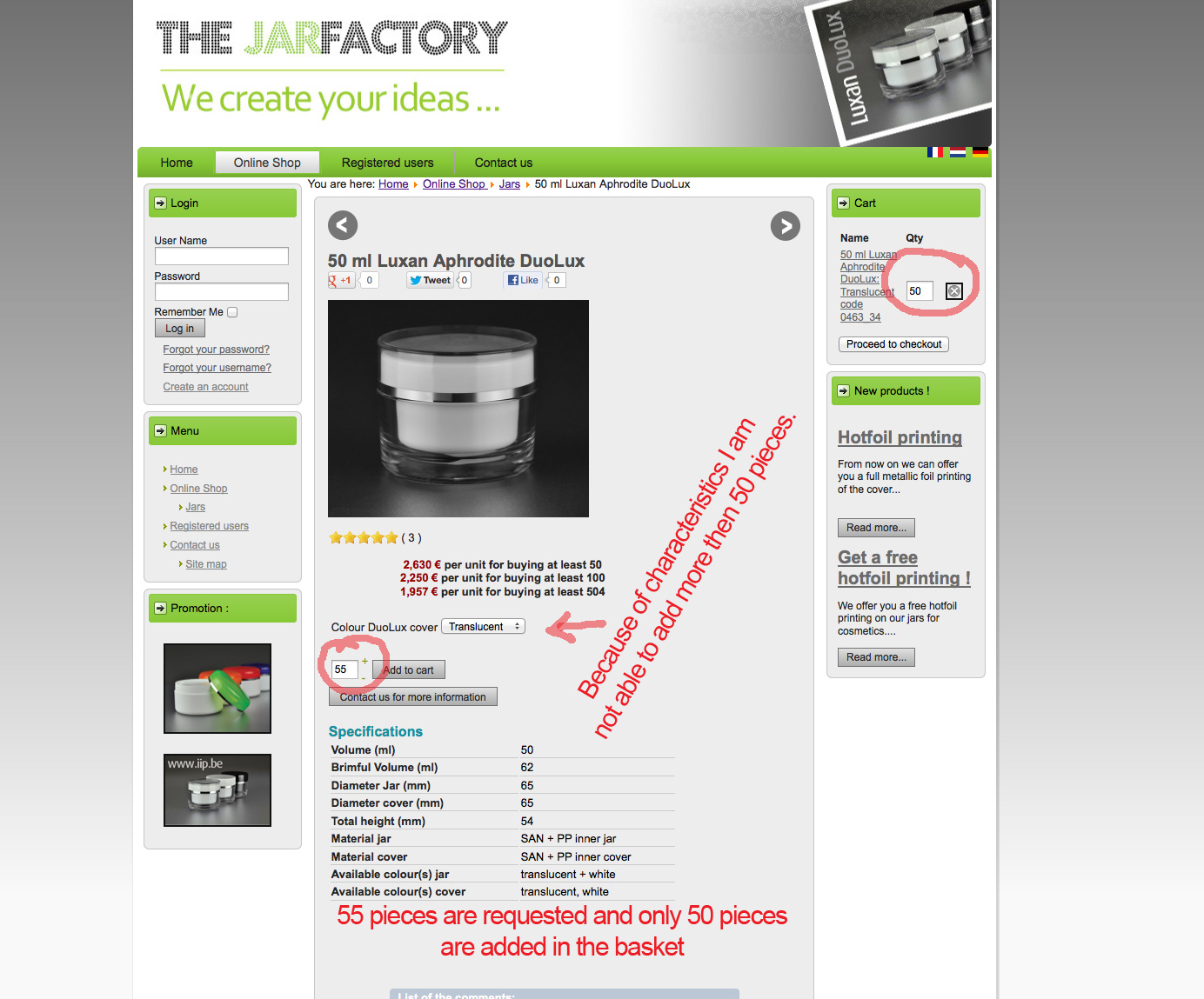

I notice a problem when add a certain article with a characteristic to the basket.
The min. quantity is set to 50 pieces.
When I enter for example 55 pieces he only add 50 pieces.
When I enter again 55 pieces then it works and he add 55 to the 50 = 105 pieces.
For the characteristics the price is set to zero and the min. quantity is also set to 50 like in the mainproduct.
When I remove the characteristic everything works fine.
So it has to do something with this.
please verify on the following link
click here

  • Posts: 88
12 years 8 months ago #60445
I have made a printscreen so you see what happend

  • Posts: 83603
  • Thank you received: 13533
12 years 8 months ago #60452
I think that it comes from the same problem as here:
www.hikashop.com/forum/4-how-to/56921-is...s.html?lang=fr#57739
Can you try the fix I provided there ?
