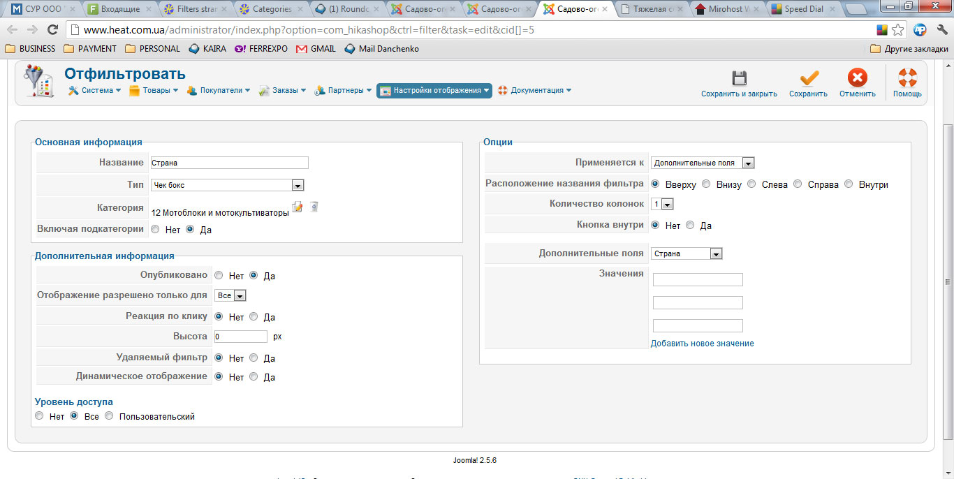

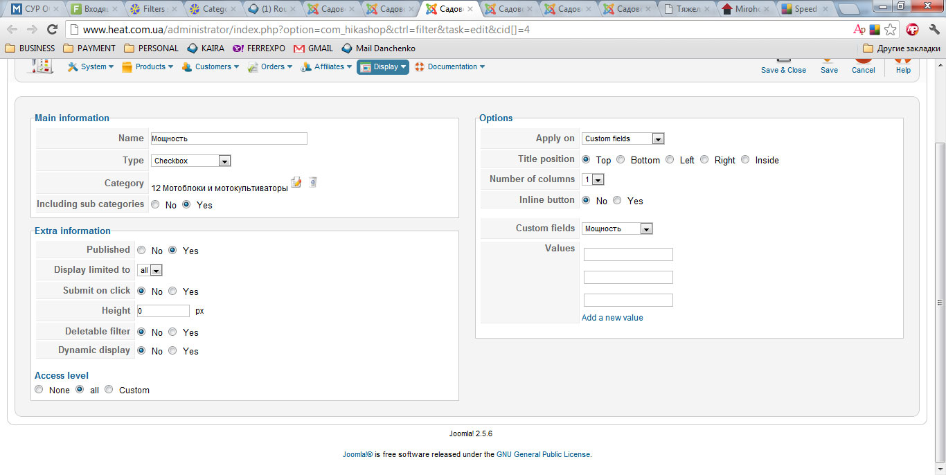

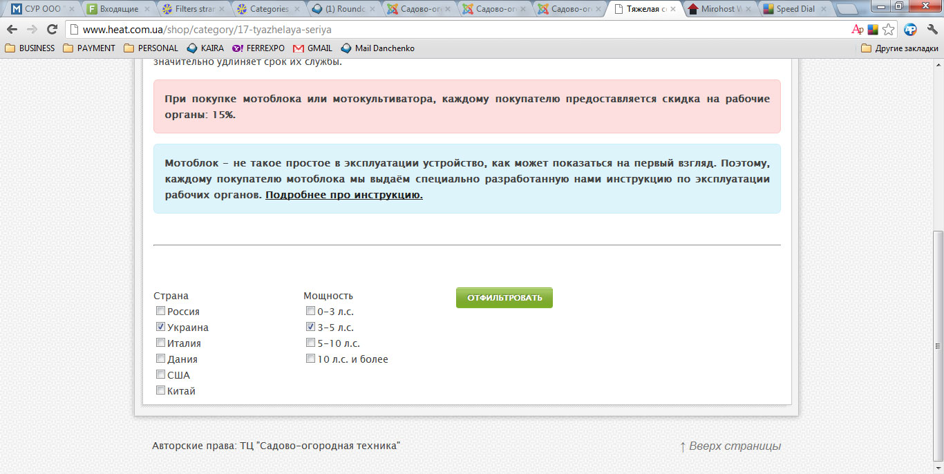

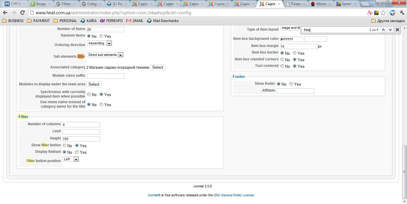

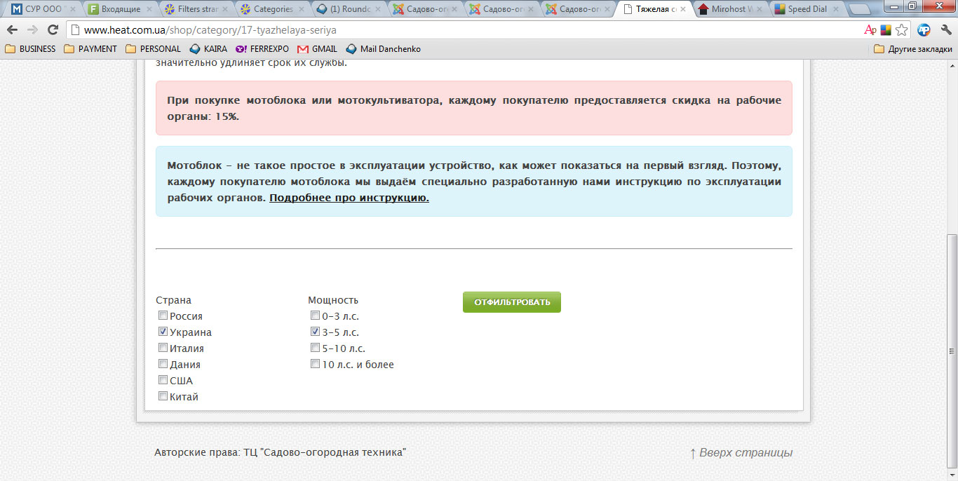

  • Posts: 120
12 years 3 months ago #61264
Please see attached screenshots.
Backend, Filter 1 settings:
Backend, Filter 2 settings:
Frontend, the issue:

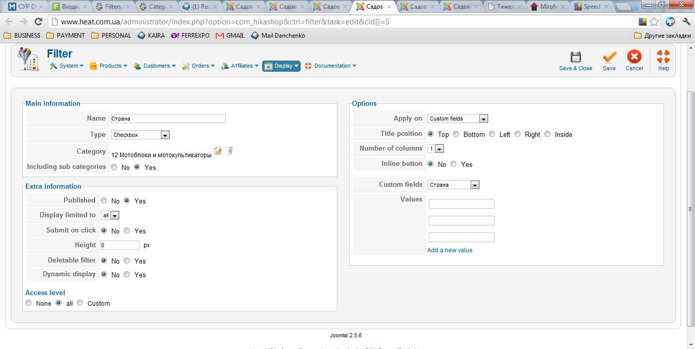

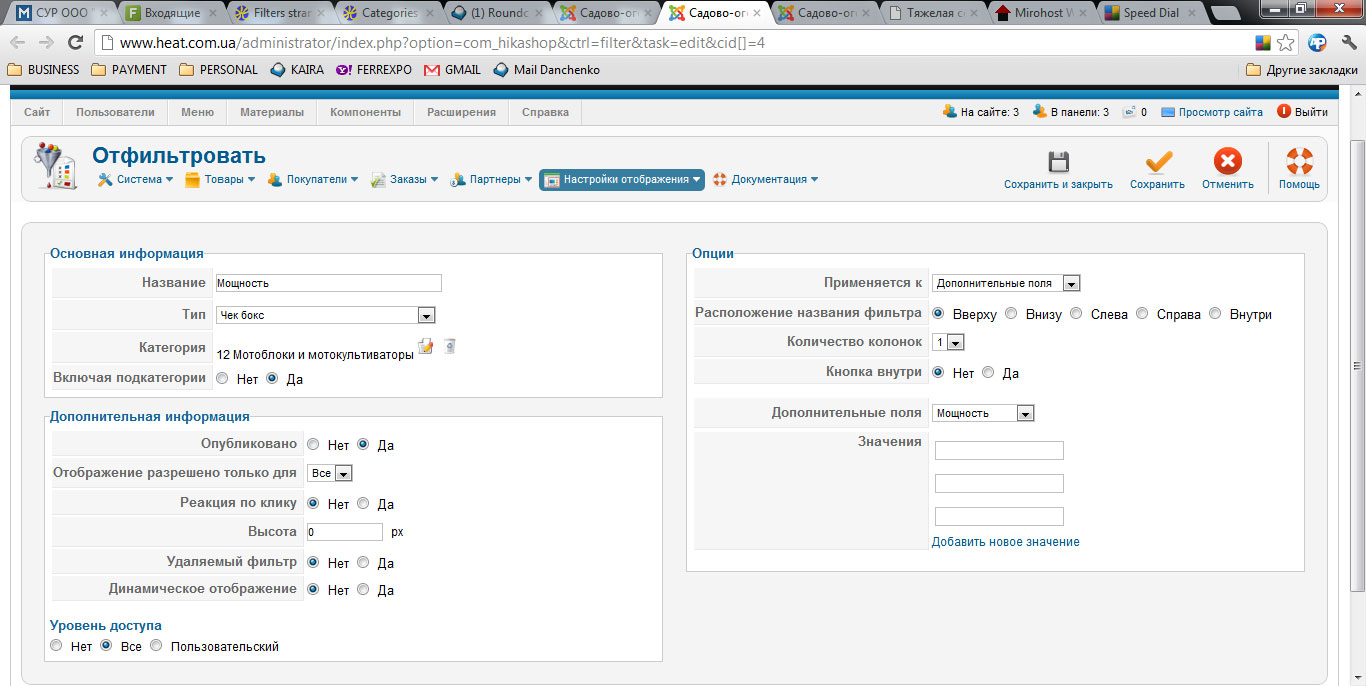

  • Posts: 120
12 years 3 months ago #61265
Oops... Sorry for Russian backend. Here are revised screenshots.. :blink:
Filter 1, Backend:
Filter 2, Backend:

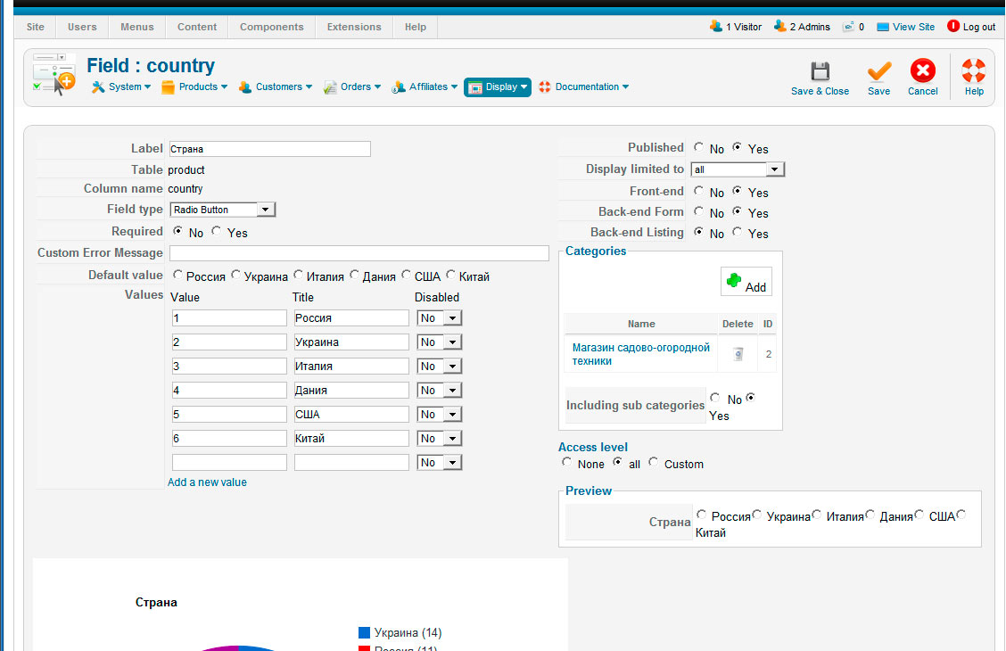

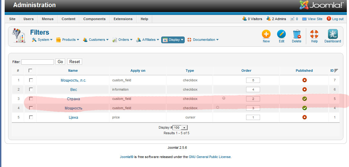

  • Posts: 120
12 years 3 months ago #61401
Hi Eliot,
Screenshot of my custom filters is attached hereto. I have marked the affected custom fields.
Details of these custom fields you can find in above screenshots.
I will also PM backend access to you.

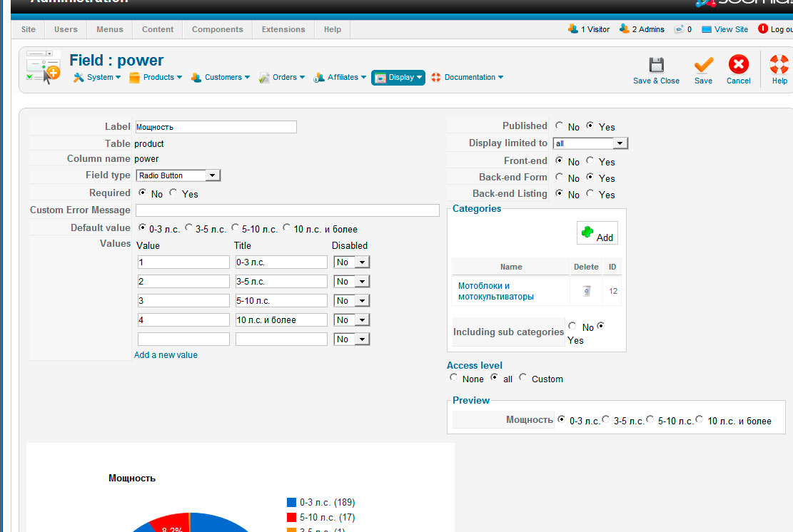

  • Posts: 120
12 years 3 months ago #61404
Oh, I understand. You want to see Custom Fields (not custom filters). Here they are:
