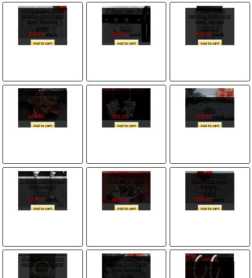

Hello
When I search products by their code usually it works perfect, but sometimes it messed up the page
This is my website address: www.pearlsbyaj.com
What is the problem?

Since I use the filter to search by product code it usually works well and it just show me one product but when i use it two or three times after that things get weird!!About the layout I am using this layout for all of my website also I don't think this problem would be relevant to the layout, because at the first two or three time it shows the search results perfectly in the layout!

Well,That's my problem it works well often but sometimes it doesn't!
Try searching g290 Because I searched it, and I got this weird result!
This is usually happens after two or three search queries!
That's all I know!

I definitely cannot reproduce the problem. First thing is that I don't see this layout anywhere on your website (img_pane with the black transparent panel) and when I'm searching I always got the right result with the right display, even with g290.
Try to find a way where you can make this problem happens all the time.
Also the problem may come from your browser. Try with another computer/browser.

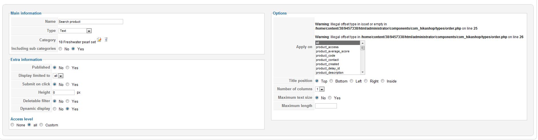

I tried other computers,other tablets and I still got this view just go to home page and search something.You can see the result.Besides since I upgraded to Hikashop 1.6 I've got the following error on the filter setting.
Warning: Illegal offset type in isset or empty in /home/content/38/9457338/html/administrator/components/com_hikashop/types/order.php on line 25
Warning: Illegal offset type in /home/content/38/9457338/html/administrator/components/com_hikashop/types/order.php on line 26
Now every search results will go to this weird page!

I was able to reproduce the problem on your website.
Go in the menu Display of the configuration and change the "item box layout" option to "image and title".
That should help displaying properly the listing results.

I downloaded the latest version again, and I uploaded the file you said manually, but it didn't work.I Attached screenshot. Although I bought the business edition, I am facing with this problem for about two weeks with no real solution.would you give me right solution please?

That's a bug in Hikashop.
To solve it, just go in the folder administrator\components\com_hikashop\types and edit the order.php file. Then replace the following line:
if(!isset($arr[$value])){
by this one:
if(!is_array($value)&& !isset($arr[$value])){

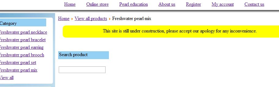

Thank you.I don't have that error message anymore but The module that I put on the left side of the box does not filter properly although the one that is in top of each page works prefect!
How to solve this one?
This is my module:
This is the one that Hikashop automatically puts on top of each page,this one works great:

Did you specify something in the 'menu' field of this module?
You have to put in this field the id of the menu you want the search to be applied on.
This should works better like this :)
