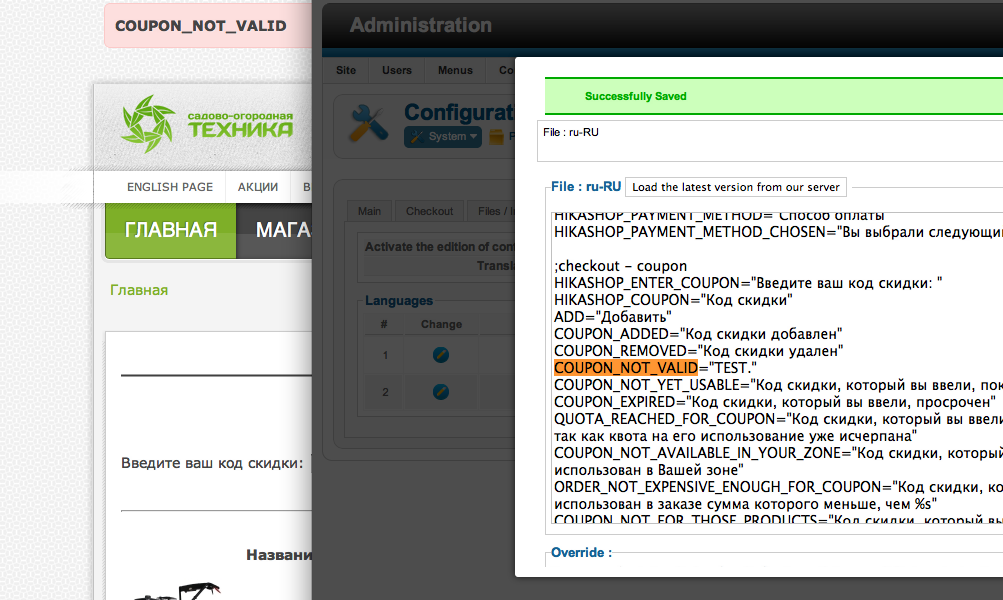

Hi All,
Can you see the below attached screenshot?
When I enter incorrect coupon code, this message appears: "COUPON_NOT_VALID"
However, the value for this string is clearly defined in language file (this is also seen from screenshot).
When I delete a coupon, translation of the message "Coupon Deleted" appears correctly.
Can you tell me how to solve this issue?

Hi watashi,
The translation has the good syntax, I can't reproduce the bug on my end.
Please check if the code for the translation in \administrator\components\com_hikashop\classes\discount.php is correct, it must be like
$error_message = JText::_('COUPON_NOT_VALID');
Maybe try to clear the cache.

The code in discount.php seems correct:
After I switched on Language Debug mode, the following errors occured, which seems to have nothing to do with HikaShop:
JROOT/templates/rt_voxel/language/en-GB/en-GB.tpl_rt_voxel.ini  имеются ошибки в строках 138, 172, 173, 183
JROOT/language/en-GB/en-GB.mod_roknavmenu.ini  имеются ошибки в строках 1, 2, 3, 4, 5, 6, 7, 8, 9, 10, 11, 12, 13
Can it be the cause? Unfortunately, I can not identify what is wrong. For example, line 138 in tpl_rt_voxel.ini says:
SIDEMENU_TITLE=Side Menu Title
It seems the reason of error are missing quote brackets. But how it can influence to our coupon_not_valid issue?

I also have AwoCoupon Pro installed. Can it be the cause? It has inserted the following code in discount.php file:
# awocoupon_code START ===============================================================
$do=true;
JPluginHelper::importPlugin( 'hikashop' );
$dispatcher =& JDispatcher::getInstance();
$item = $dispatcher->trigger( 'onBeforeCouponLoad', array( &$coupon, & $do) );
if(!$do) return current($item);
# awocoupon_code END =================================================================
In debug mode I have following files, which were not loaded:
**Не загружен** : JROOT/language/ru-RU/ru-RU.mod_hikashop_cart.ini
**Не загружен** : JROOT/modules/mod_hikashop_cart/language/ru-RU/ru-RU.mod_hikashop_cart.ini
**Не загружен** : JROOT/language/en-GB/en-GB.mod_hikashop_cart.ini
**Не загружен** : JROOT/modules/mod_hikashop_cart/language/en-GB/en-GB.mod_hikashop_cart.ini
I have following strings which are detected as "not translated" when Language Debug mode is ON:
# JROOT/libraries/joomla/application/component/view.php
DISPLAY_THE_CART="THE CART"
PRICE_BEGINNING_0="BEGINNING 0"
PRICE_ENDING_0="ENDING 0"
I have also made a language override for COUPON_NOT_VALID, which did not work for me as well..
I have cleared browser's cash. I have also tried to see the page from another browser on another PC under different OS.
What else can I try? Any idea?...

Hi watashi,
Maybe AwoCoupon got the same text to translate than HikaShop, try to change the code in discount.php from COUPON_NOT_VALID to HIKA_COUPON_NOT_VALID
And change it too in the translation file.

12 years 7 months ago #62523
Thanks for advice. I have replaced it as per your advice in both php and language files.
However, I still get the same message COUPON_NOT_VALID.
In such a case I understand that it is generated not by Hikashop, but by AwoCoupon.
I have contacted AwoCoupon team and will wait for their reply.
  • Posts: 120
12 years 7 months ago #62527
This solution worked for me:
awodev.com/forum/awocoupon/help-section/couponnotvalid
So the bug was at AwoCoupon's side.
