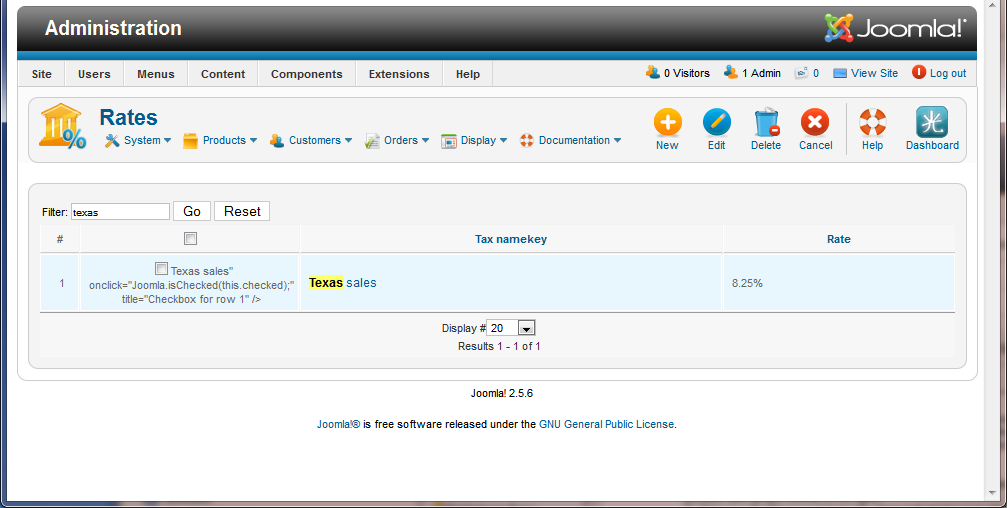

After adding a tax rate, the on-screen display includes Javascript "onclick" code.
The 'new' form for tax rates allows entry of a "Tax namekey" that contains spaces. Is this coded for, or should it be caught/disallowed?
After this has appeared, there is no way to edit the namekey itself. And if you check the box for line 1, then choose "Edit", it warns you that nothing has been selected.
(This is while using the
latest version of HS, downloaded & installed this morning.)

I'm not sure about what you mean with the onclick code ? I'm able to edit the rates with the checkbox+edit button without any error on my end.
Indeed, the namekey cannot be changed once entered.
You can always create a new one and edit your tax rules to use that new tax rate.

Sorry--didn't get the image inserted. Check original message for png.

In the cycle of editing and refreshing, the error persisted until yesterday afternoon, then it vanished.
(Unless a new release came out yesterday, this is the latest version, of HikaShop, Joomla! and all other components/modules/plugins. [I'm using the latest Firefox.])
Looks like I may have hit a refresh/cache-handling/formatter blip between HS, J! & FF.
