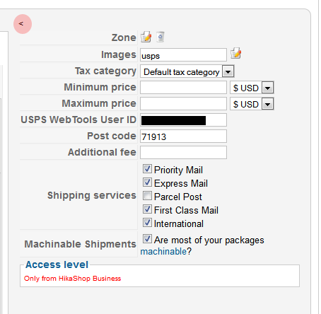

12 years 7 months ago #62844
Can you test it with weight into your variants and without the "Force shipping regardless of weight", then if the UPS method don't show can you send me a screenshot of your UPS configuration ?
