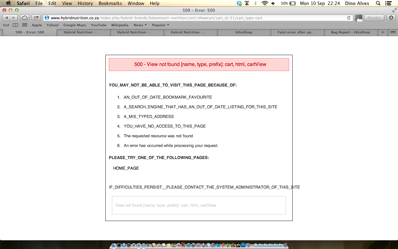

  • Posts: 3
12 years 7 months ago #64816
I update my hikashop starter to 1.6.0 but my "My Cart" Module is taking me to a page showing Error 500 500 - View not found [name, type, prefix]: cart, html, cartView
Please can someone help me with this? As it is very important that our site is back online properly for customers.
I attached a screen shot of the error
  • Posts: 83603
  • Thank you received: 13533
12 years 7 months ago #64818
Please turn on the debug mode of the joomla configuration and try again. Then do a screenshot again.
That ill give an error message with more information on what is going on.
