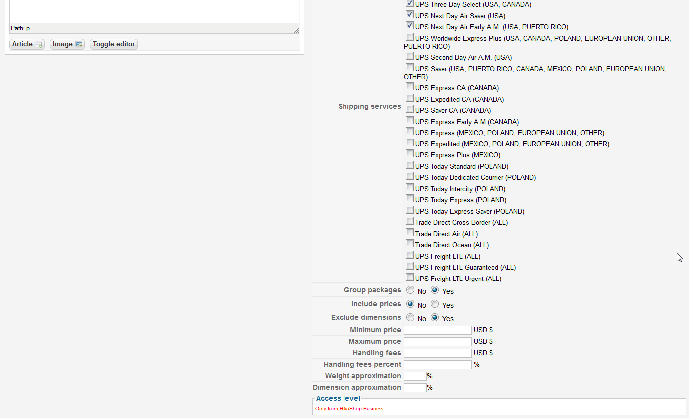

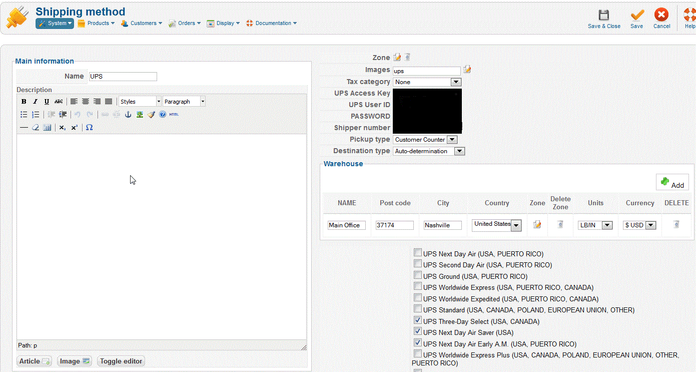

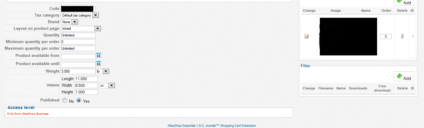

I have read through the forums and have tried a variety of combinations in order to get UPS shipping to show-up on checkout.
I have attached a few screenshots to show my settings. I had added weights and dimensions to my two test products and have tried it with dimensions included and excluded. If someone could assist me, I would greatly appreciate it.

Three things I can see :
1. Check that the warehouse zone is the USA and not the USA minor Islands or some other zone with the same beginning.
2. Save the options of the plugin in the joomla plugins manager.
3. Maybe the methods you selected are not available in your case. Try to tick them all.

I checked that the zone is in the United States of America and have saved the plugin using the Joomla plugin manager. I also checked all of the boxes for shipping option - but still no luck.
As far as I know, I dont have any specific shipping zones setup so I dont think thats the problem. Also, if I use the manual shipping option, my selections show up on checkout.
