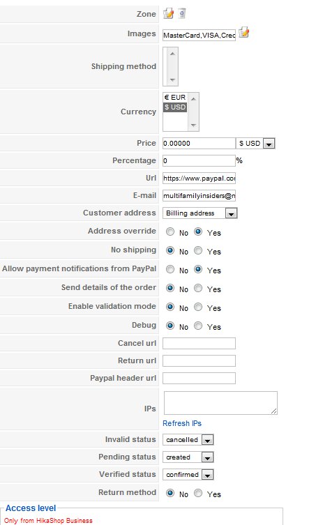

Can you show me how did you configured you Paypal method with a screenshot ?
  • Posts: 78
  • Thank you received: 5
12 years 7 months ago #66423
Sure, thanks! (By the way, I have tested with the "Return Method" both off and on.)
