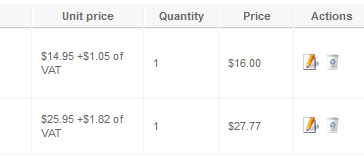

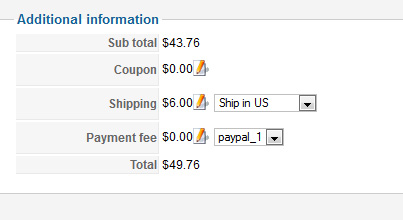

I ran into similar problem. The order set to cancelled because of the rounding problem on hikashop not agreeing with paypal. There is 7% tax charge on all products. If I look at the detail product list under the order information on hikashop backend (see attached pricelist), $14.95 +$1.05 + $25.95 +$1.82 should add up to $43.77 and then if you add shipping of $6, the grand total should be $49.77 (which is what paypal used). If I look at the top port under additional information in the order information on hikashop backend (see attached totalprice), it show $43.76+shipping totalling $49.76 instead. If the bottom product list adds up to $49.77, shouldn't the top (under additional information) match? Depending where you look Print Invoice (from order page), or product list, or additional information, they have different total. My client prefer printing shipping label (what she use to as well) on paypal. She also want full detail from paypal side as well.
