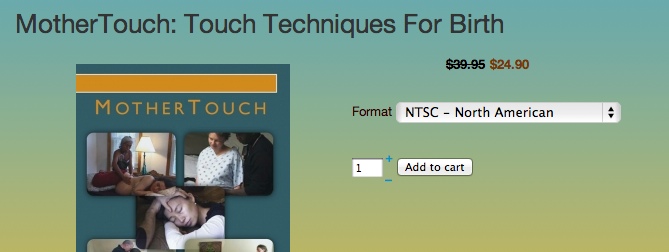

I have a product that is $55.00. I created a discount, just for this product, that is $15.05, so the final price of the product is $39.95. However when you look at the product in the front end, you see that the product price is shown at $39.95, crossed out, with the final price at $24.90. It looks like the discount is being applied twice.

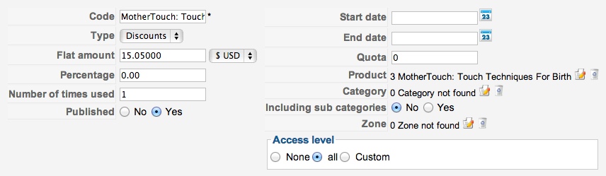

Can you show me with screenshots how did you configured your discounts ?

Sure thing. Attached are three screenshots. The first shows the discount setup. The next shows the price as displayed in a HikaShop module. The price shows correctly there. The final screenshot shows the price on the product page, after you click on the product in the module. You can see how the discount is applied, and then applied again.

I checked your website. The price of that product is $39.95, not $55. When the discount is unpbulished, the price of $39.95 is displayed everywhere. If you publish the discount of $15.05, the price becomes $24.90 in the product page but also on the listing of products. So it's perfectly working as far as I can see.

It is not working perfectly. I had to unpublish the discount and change the actual price of the product so that we could get around this problem, as the client could not afford any more purchases of the items at BELOW the intended sale price. The problem still exists. If the product price is changed to $55, and the discount is published, by the time to user gets to the actual product page, and then checks out, the discount of $15.05 has been applied twice.
Trust me, the issue still exists. I can replicate it at any time.
  • Posts: 83603
  • Thank you received: 13535
12 years 5 months ago #72129
The problem does not exist.
I've checked again and it's working.
I've left it with the price of 55 so that you can see.
You must have forgotten to change the price of the variant...
When you have variants with prices, it's of course the price of the variant which is used. However, if you set a price on the main product, that's this price which will be used on the listing of products instead of one of the prices of the variants.
