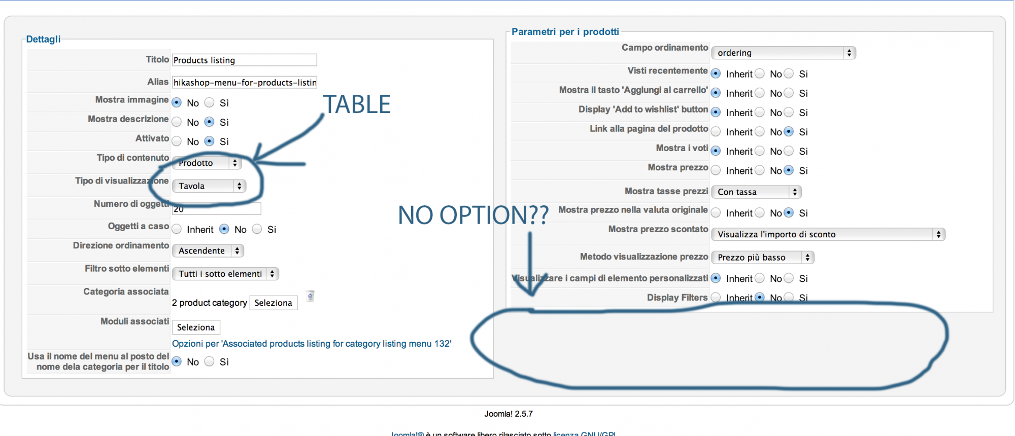

  • Posts: 25
13 years 11 months ago #69800
no option for table layout
13 years 11 months ago #69803
Ok, then you should just :
- Set your "Type of layout" to DIV
- Set your "Image width/height"
- SAVE
- Set your "Type of layout" to table again
  • Posts: 25
13 years 11 months ago #69804
I tried but does not work

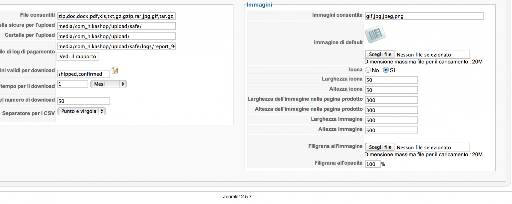

  • Posts: 25
13 years 11 months ago #69944
1.The fields are not empty!
I set the image size to 300x300 for product page, and 50x50 for thumbnail.
But the thumbnail in product table listing layout is 300x300.
2. PHP Fatal error: Call to a member function get() on a non-object in /home/newdigilab/public_html/templates/web/html/com_hikashop/product/compare.php on line 82

  • Posts: 86187
13 years 11 months ago #70016
1. Then, it means that in the hikashop options of your listing menu, you have set the images width/height to 300*300. If you leave them empty, it will take the size of 50*50 that you have in the configuration.
