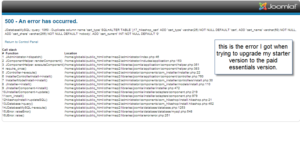

I tried to upgrade my starter to essentials today after purchasing it. I did as instructed and simply installed it over our starter package. I got php errors with a 500 page upon install and now I have php errors in the control panel of Hika shop.
Please advise.
I am using Joomla 2.57
  • Posts: 83603
  • Thank you received: 13533
12 years 5 months ago #71699
You have that problem:
www.hikashop.com/en/support/documentatio...lity-issues.html#SQL

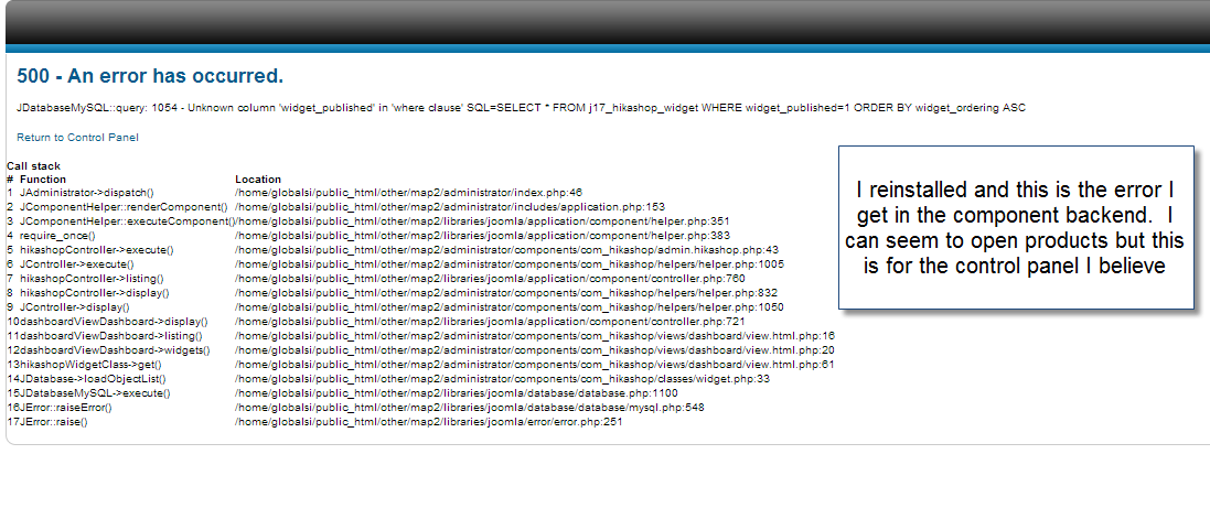

I actually had the debug on when this showed.
After I turn the debug off, here is the error message in Hikashop:
Warning: Invalid argument supplied for foreach() in /home/globalsi/public_html/other/map2/administrator/components/com_hikashop/views/dashboard/view.html.php on line 62
Warning: Invalid argument supplied for foreach() in /home/globalsi/public_html/other/map2/administrator/components/com_hikashop/views/dashboard/tmpl/listing.php on line 15
  • Posts: 83603
12 years 5 months ago #71703
These new errors are just the results of the first ones. Please follow the documentation.

  • Posts: 83603
12 years 5 months ago #71719
On the screenshot, the query error is on the field widget_published, not field_value so you would have to run that one:
ALTER TABLE `#__hikashop_widget` ADD `widget_published` tinyint(4) NOT NULL DEFAULT 1,
ADD `widget_ordering` int(11) NOT NULL DEFAULT 0,
ADD `widget_access` varchar(250) NOT NULL DEFAULT 'all'
  • Posts: 4
12 years 5 months ago #71729
Thanks - that fixed it.
Not sure why this was messed up in the first place, but at least now it is working!
