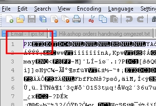

When I download a bought file via HikaShop (ZIP file) it gets corrupted during download.
When I download the same file via my own php script, the file is ok.

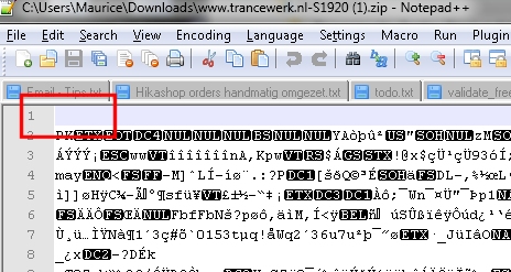

After comparing the corrupted ZIP-file and the correct ZIP-file in a HEX Editor, I see that in
the corrupted file line 1 is empty. The actual code starts at line 2.
The correct file's code starts at line 1, as it should.
When I manually delete the first emtpy line in the corrupt file and save it. It's repaired and it works. I can open and unzip the file.
So somewhere the HikaShop PHP code adds this first emtpy line in the download files.
This is the correct file. See the code starts at line 1
This is the corrupted file. See the code starts at line 2
Please help.
