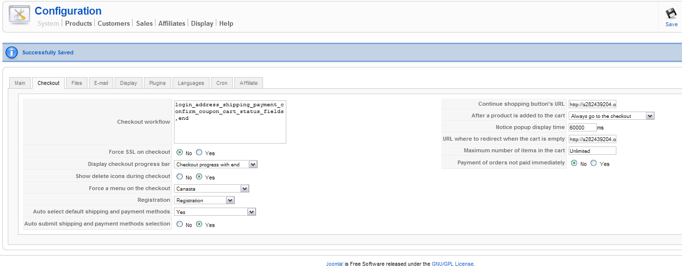

14 years 2 months ago #7479
Could you send us a screenshot of your checkout tab in the configuration of HikaShop so that we can reproduce the problems on our end ?
  • Posts: 188
14 years 2 months ago #7480
Here is the pic
  • Posts: 83603
  • Thank you received: 13533
14 years 2 months ago #7481
Thank you. We'll review the problem and keep you posted.

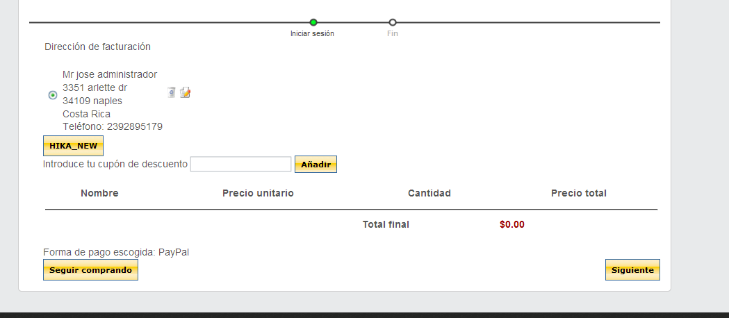

Work great thanks so much, I note this went I delete all products still show like a invisible product , look at the pic , thanks
  • Posts: 83603
14 years 2 months ago #7614
Unfortunately, we couldn't reproduce that problem on our end.
