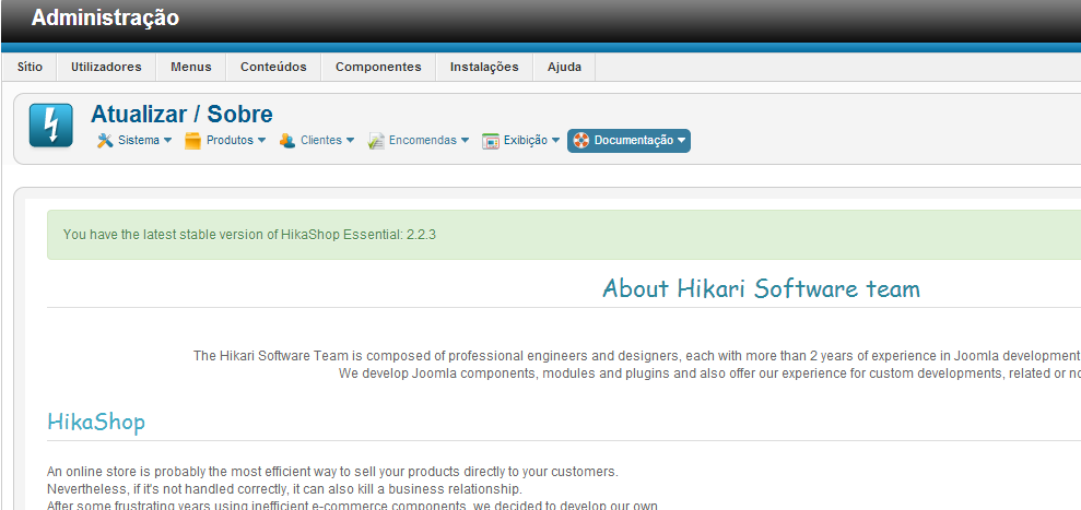

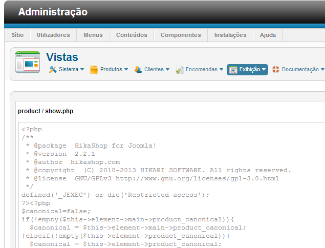

Hi Jerome.
Thank you for your quick reply.
In fact we are using version 2.2.3 as you can see from the screenshot below, yet most of our .php files are from version 2.2.1
We did start out by testing the free version 2.2.1 and proceeded to purchase the essential version after testing.
When we installed essential version it automatically updated to version 2.2.3
Are we missing something here?

11 years 2 months ago #142406
When you create a view override, you override the current view file.
So when you update, you keep your overrides. It is the base of the feature of the overrides.
So if you have an override for a view originally made in HikaShop 2.2.1, the used file will stay the same and the version indicate from "when" you made your override.
You can remove your override and restore the original file (at this moment, from the current version : 2.2.3) or you can patch your override if you want to keep your modifications.
