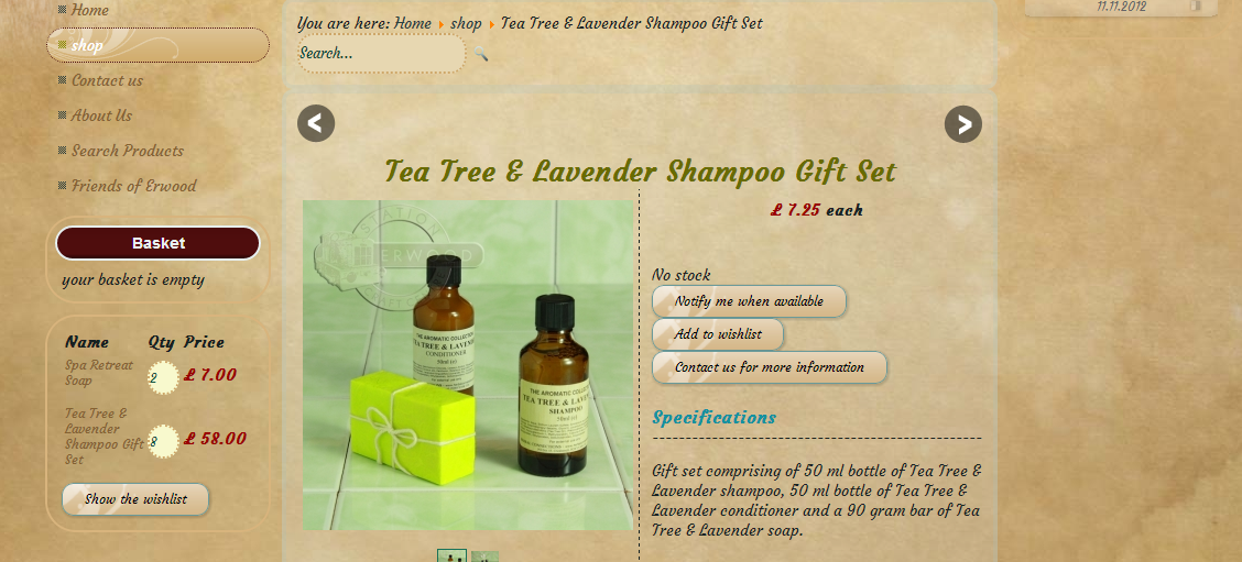

Have just had to put a site live on the Hikashop business package...

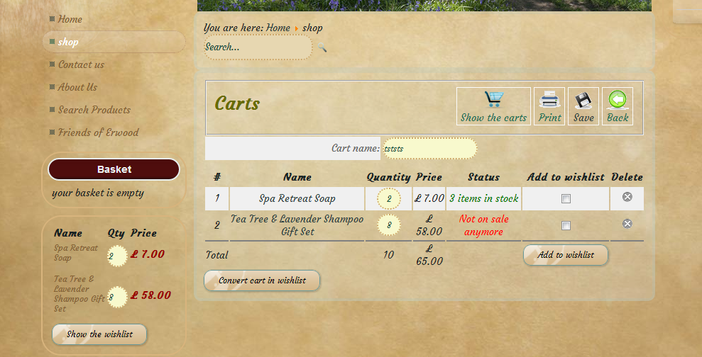

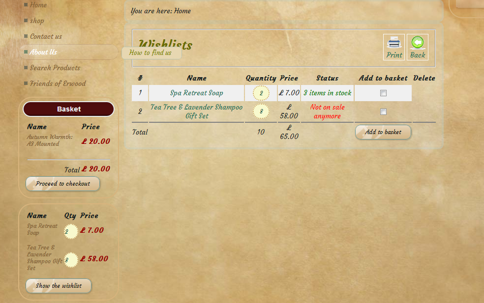

Unfortunately I think there may be a problem with the wishlist, as it shows cart in the heading when you display wishlist and ask you if you want top add from cart to wishlist...If you log in as admin it seems to be fine..sometimes.

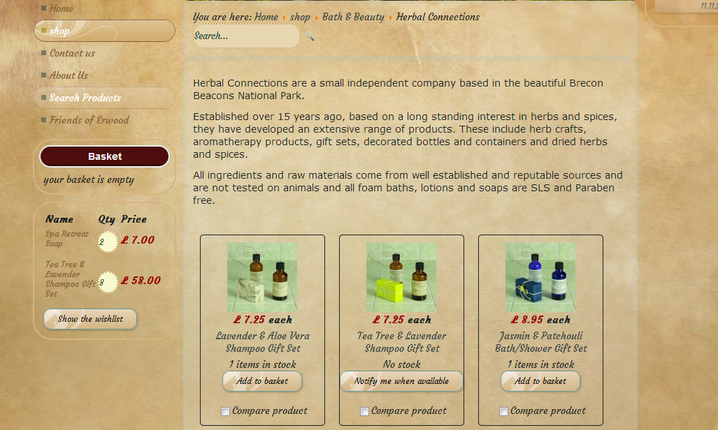

Also, when drilling down through categories the breadcrumb gets broken after entering the sub category...Which means the user has to go back up two pages on the breadcrumb to get back to where they were. Any Ideas how to get around this?

Thanks for the report, to correct the wishlist display when not logged in, can you edit the file: "components/com_hikashop/views/cart/view.html.php" in the function "showcart()" add the line:
JRequest::setVar('cart_type',$cart_type);
Before:
$module = hikashop_get('helper.module');
Concerning the breadcrumbs, that's because you are using the "Simplified breadcrumbs", disable this option in HikaShop > Configuration > Main.
