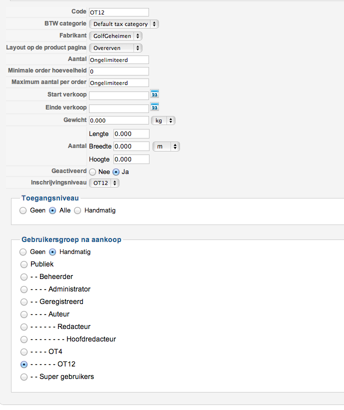

article setting:

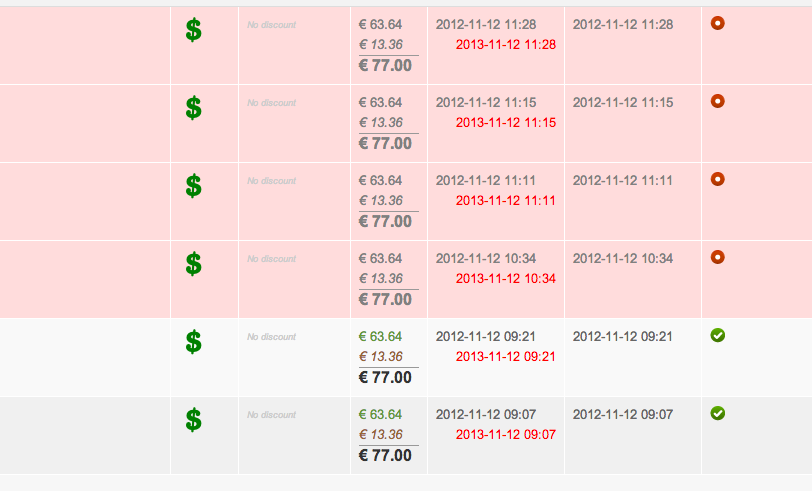

Result in ASUBS:
All of these ordered the same item, the red ones with coupon code of 100% (= free)

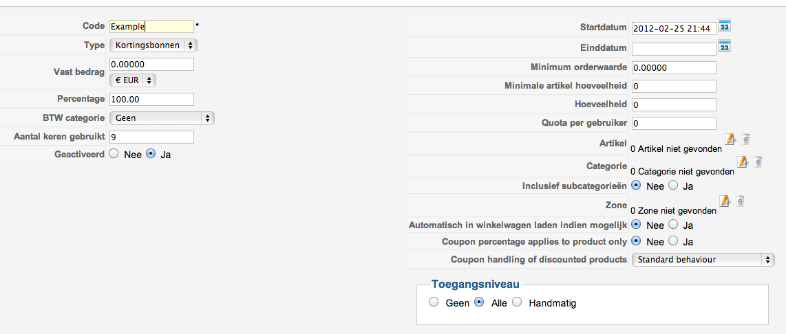

Can you give me a screenshot of your coupon configuration ? So I can reproduce the problem on my end.
And when I was asking you which version you have, I was talking about the Joomla - HikaShop versions ;)
