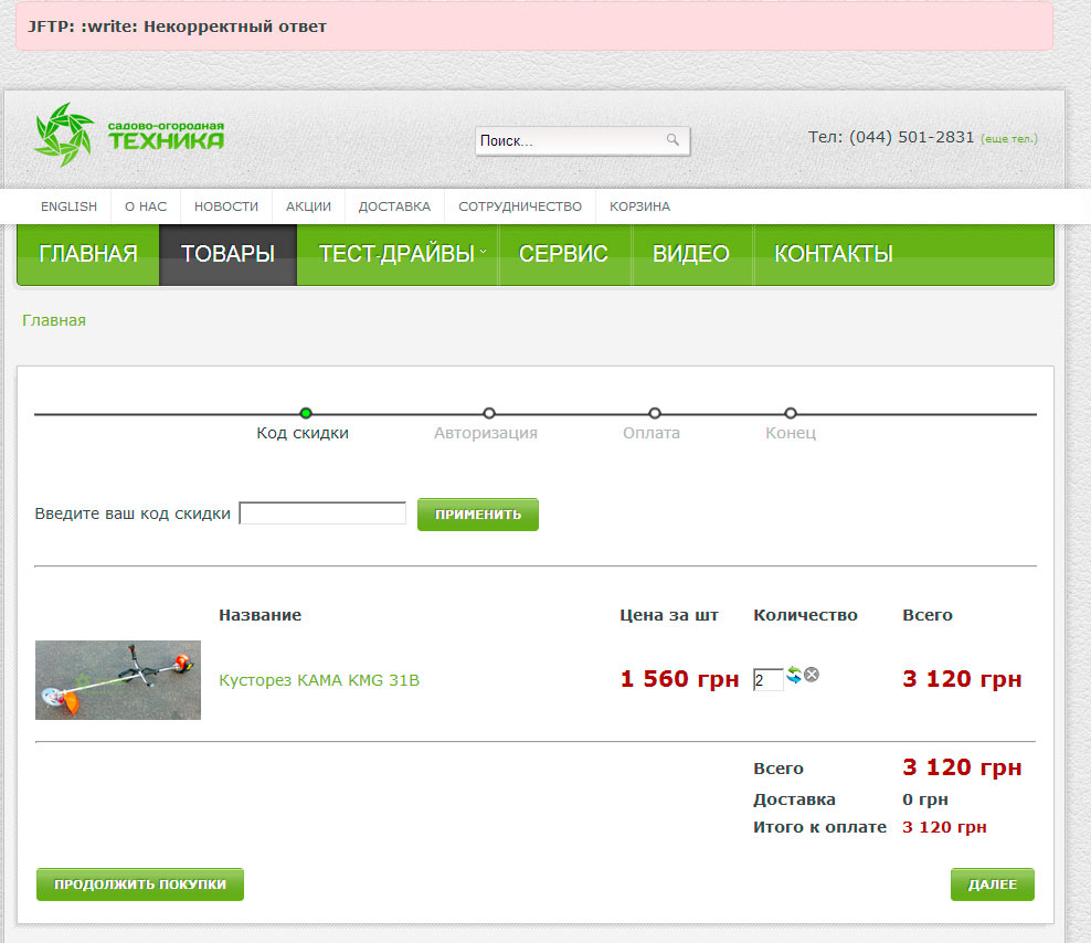

I am running my web site for a few months already. Everything was smooth, but today suddenly a error started to apper when I proceed to checkout page:
JFTP: :write: Bad Response
Apparently, some folder permissions have been changed occasionally, but what folder is affected?
Server Access Logs:
22:43:36 193.254.220.72 "GET /shop/checkout HTTP/1.1" 200 11287 " sitename.com/shop/product/cid-769 " "Mozilla/5.0 (Windows NT 6.1; WOW64) AppleWebKit/537.11 (KHTML
22:43:35 193.254.220.72 "POST /shop/product/updatecart HTTP/1.1" 303 0 " sitename.com/shop/product/cid-769 " "Mozilla/5.0 (Windows NT 6.1; WOW64) AppleWebKit/537.11 (KHTML
No Error logs at server side.
I tried to switch on Debug Mode, but I receive following error, which seems to be a Joomla bug (?):
Catchable fatal error: Object of class stdClass could not be converted to string in /home/watashi/sad-ogorod.com.ua/www/plugins/system/debug/debug.php on line 303
Therefore, I have turn off debug mode again.

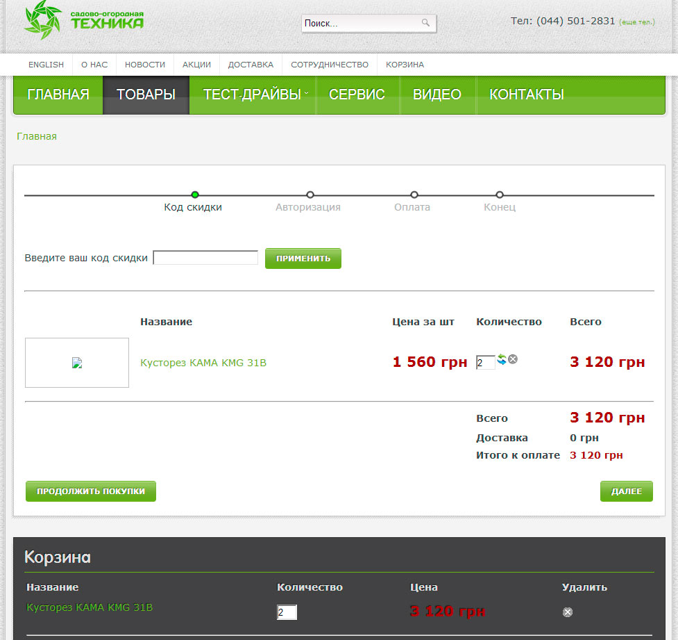

I also tried to turn off FTP LAYER, but then the picture of product in the checkout page has disappeared.
FTP LAYER ENABLED (See error on top)
FTP LAYER DISABLED: (no error, but product image is not shown).

The thing that I don't understand is that, you do not require to generate the thumbnail because the image has the right size.
I have made such patch but maybe my patch is not yet included in HikaShop 2.0
But, that's another point.
About your image generation, Having an FTP access to the HikaShop website would help me to make some debug.
The idea is to print the file path when JFTP::write return an error. So you would be able to see where the file should be create/modified.
