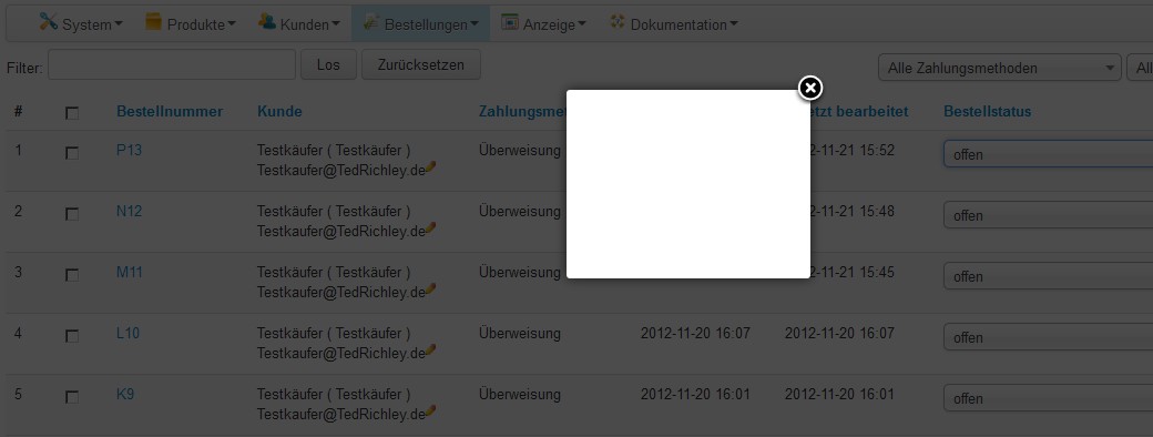

I've encountered several problems with HikaShop2.0.0 on Joomla 3.0
- Status is not changable whether in list nor in order; a white, empty popup opens without any text

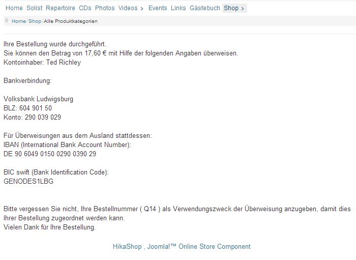

- payment mode "Prepaid" via Bank transfer: except of the confirmation page after checkout no further bank transfer information is given too the customer (nor email, nor anywhere else on shop)

1. I meant, the status cannot be changed, will say, status "created" can't be changed in any of the other statuses. Trying this will result in an empty popup window (regard attached screenshot)

I've received the email of you order, is without given bank transfer info. The only part where this data is shown to the customer, ist on the checkout screen, which you've postet above...

The payment plugin can't modify the email content but you can do it using translation overrides or email modifications (using Essential or Business version of HikaShop).
So, you would be able to put your bank transfer info into the customer email.
You can verify this issue by means of the special account I've sent you via PN

As I said, you can use a translation override.
Translation override does not require commercial version of HikaShop.
You can use the translation key "THANK_YOU_FOR_YOUR_ORDER" which is displayed at the end of the email.
I tried on your website and I could see the popup content. I did not change the order status but I can't have the empty popup like in your screenshot.
Unfortunately this variable doesn't support <br/>, so instead I used the variable "BEST_REGARDS_CUSTOMER" which makes my bank transfer data appear at the bottom of the email :-)

I've updated to the most recent version (com_hikashop_starter_2.0.0_2012-11-28.zip) but still it doesn't work. Overmore I recognized that within orders none of these pull down buttons work correctly - an empty window appears in every case

The popup helper is right used in the order listing. So the result popup should be a Joomla 3.0 popup, not an "old" Joomla 2.5 style popup.
We have tried with the latest published version (12/12/12) and we do not have such problem.
Without more information, without access, it would not be possible to us to understand your problem and fix it.
Did you make a override on the backend order listing ?

When trying to change the order status, the Web Console of Firefox shows the following:
[16:50:56.464] Leerer String an getElementById() übergeben. @ www.tedrichley.de/media/jui/js/jquery.min.js:2
[16:50:58.445] GET http://www. tedrichley .de/administrator/index.php?option=com_hikashop&ctrl=order&task=changestatus&order_id=37&tmpl=component&status=confirmed [HTTP/1.1 200 OK 1281ms]
[16:50:59.658] Fehler beim Verarbeiten des Wertes für 'height'. Deklaration ignoriert. @ http://www. tedrichley .de/administrator/index.php?option=com_hikashop&ctrl=order&order_type=sale&filter_partner=0
[16:50:59.660] NS_ERROR_XPC_BAD_CONVERT_JS: Could not convert JavaScript argument arg 0 [nsIDOMHTMLDivElement.contains] @ www.tedrichley.de/media/system/js/modal.js:15
[16:52:26.947] Leerer String an getElementById() übergeben. @ http://www. tedrichley .de/media/jui/js/jquery.min.js:2

Your log seems right, the popup content is loaded.
A backend access should help. You can send it by private message. So we would test your website and check it.
With a backend access, we would be able to update your HikaShop store with a fixed package too.

I don't know why but the old popup system (from J2.5) is loaded in your backend so, the status notification popup was not call the right system.
In Chrome, the popup works fine but in Firefox, not.
So I have made a little patch in your views and I will submit a little patch for HikaShop in order to add some checks.

GREAT! Genious! It works :-) Thank you so much Jerome!
