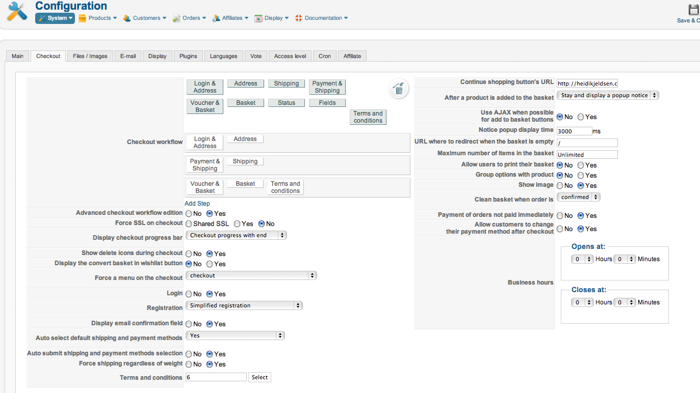

@PhantomPWR And could you provide a screenshot of the Checkout tab of the HikaShop configuration on your website please ?

I've attached my checkout configuration.
I don't know if it's relevant, but I've also modified the checkout->step view to change the 'next' button to 'confirm order' in the final step.
The unusual names in the workflow is because I've added language overrides for the progress bar to display properly.

Did you do any other overrides in the checkout view files ? If so, please remove all of them and try again.
Your settings are fine and there is no such problem with the latest version of Hikashop so it must come from a view file of a previous version of HikaShop. That's all I can think of.

I changed my workflow to: login_address,coupon_cart,payment_shipping_cart,cart_status_terms_confirm,end
I don't know why it works, but it does. :woohoo:
Now I just need the payment selection to stay on the same step when it (auto)submits. Is this possible?

I have:
1. Auto select default shipping and payment methods: YES
2. Auto submit shipping and payment methods selection: YES
If #2 is not on auto submit, then the user has to click 'Next' twice, which is not good.
  • Posts: 82863
  • Thank you received: 13372
11 years 11 months ago #80552
It's normal that the system moves to the next step when you select a payment method and that the option #2 is activated.
That can't be changed.
It's also normal that the user has to validate twice when that option is turned off. One to submit the selection, and a second time to go to the next step.
