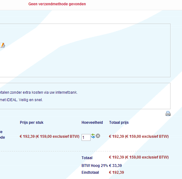

After upgrading Hikashop I get the message that the shipping method is not found. This only occurs when the weight = 0. For all other weights there is no problem.

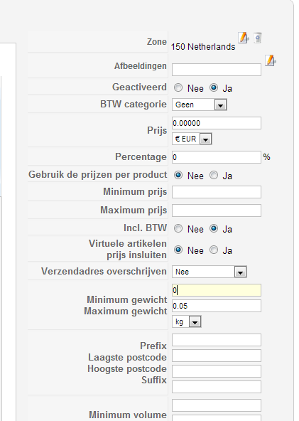

I defined a shipping method for weight = 0 long ago and it always worked fine. Attached its config. Any idea?

12 years 7 months ago #78361
You have to enable the option "Force shipping regardless of weight" in HikaShop > Configuration > Display.
And the option "Virtual article.." in your shipping method configuration.
