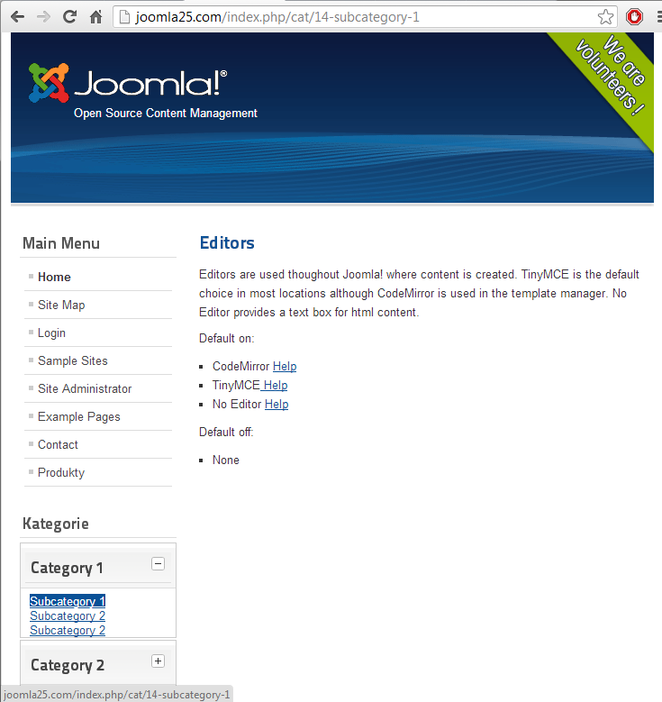

  • Posts: 4
11 years 11 months ago #79105
Here's configuration:
Simplified breadcrumbs: Yes
Activate smaller url: Yes
Category SEF name: cat
Product SEF name: prod
I,ve attached a screen.
The URL is: joomla25.com/index.php/cat/14-subcategory-1
Using this URL hikashop's route.php isn't used and joomla uses com_content component, and that's the problem.

  • Posts: 26158
  • Thank you received: 4028
11 years 11 months ago #79295
Your links does not have "component/hikashop" at the beginning.
Real url would be : joomla25.webwood.pl/component/hikashop/cat/12-category-1
You don't have a menu which would point to hikashop so, your url should have an information in order to know that, it has to call HikaShop.
Otherwise, if you have a hikashop menu, you can use it (like "/shop/") and your url would become joomla25.webwood.pl/shop/cat/12-category-1
The following user(s) said Thank You: xaze
