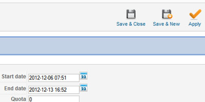

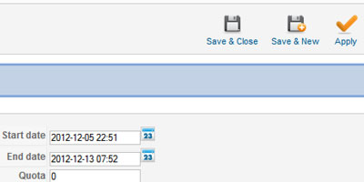

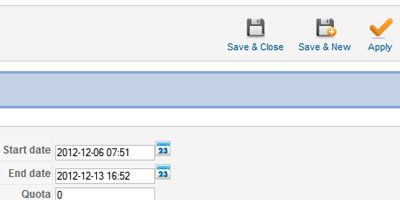

When entering the start date and finish date, and pushing save or apply, then the time is changing. somehow it is not possible to set the time and keep it. it does always goes forward and if pushing several times apply, then even the date will change.
please see the print screens I made for this.
After saving or pushing apply the time changes!
Is there a explanation for this behavior?
How can this be fixed?
Best regards
Raphael
