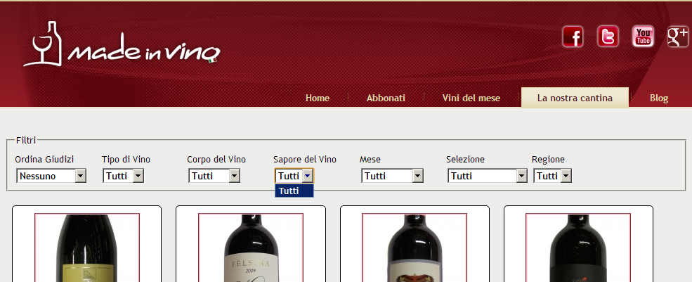

Hello
i have some problems with filters.
Today I added 2 new filters ("Sapore di vino" and "regione").
They are equal to the old filters, unfortunately they are not working.
I can see the filter in the module but there is no value inside.
You can verify it with www.madeinvino.com/la-nostra-cantina.html
Is it a bug of my version (1.6.0) or is there something else?

11 years 11 months ago #80223
Are you sure that in the listing there is products with the custom field "Sapore del Vino" filled ?
Else you can try to update your HikaShop version to the newest one 2.0. I recommend to try in test environment and backup your site.

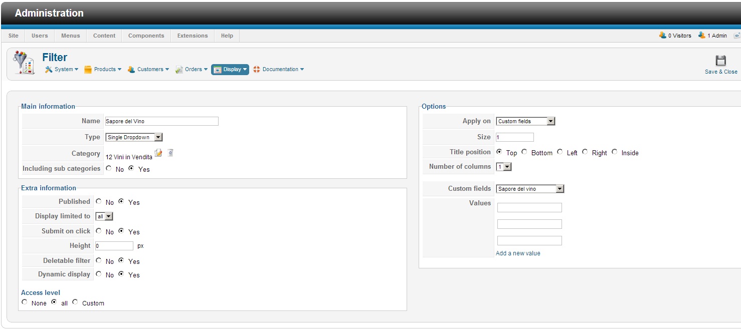

11 years 11 months ago #80438
You have to enter the values of the custom field Sapore del vino in the filter values

11 years 11 months ago #80689
It seems that you have an error when saving the custom field "Sapore":
Warning: strip_tags() expects parameter 1 to be string, array given in /home/madeinvi/public_html/administrator/components/com_hikashop/classes/field.php on line 763
Could you give us a ftp access ?

11 years 11 months ago #81069
It's just that the products need to be saved with the values of the custom field selected for them.
Otherwise, since you activated the dynamic display option of the filter, the filter will only display the values selected for the products displayed.
I've turned off the dynamic display option of the filter and it's fine now.

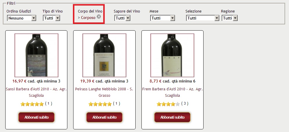

  • Posts: 184
  • Thank you received: 4
11 years 11 months ago #81599
Hello Nicolas
I saved all the products with the correct values for the new custom field but unfortunately the dynamic option doesn't work anyway.
I turned oft the dynamic option and not it is working.
Do you know why?
