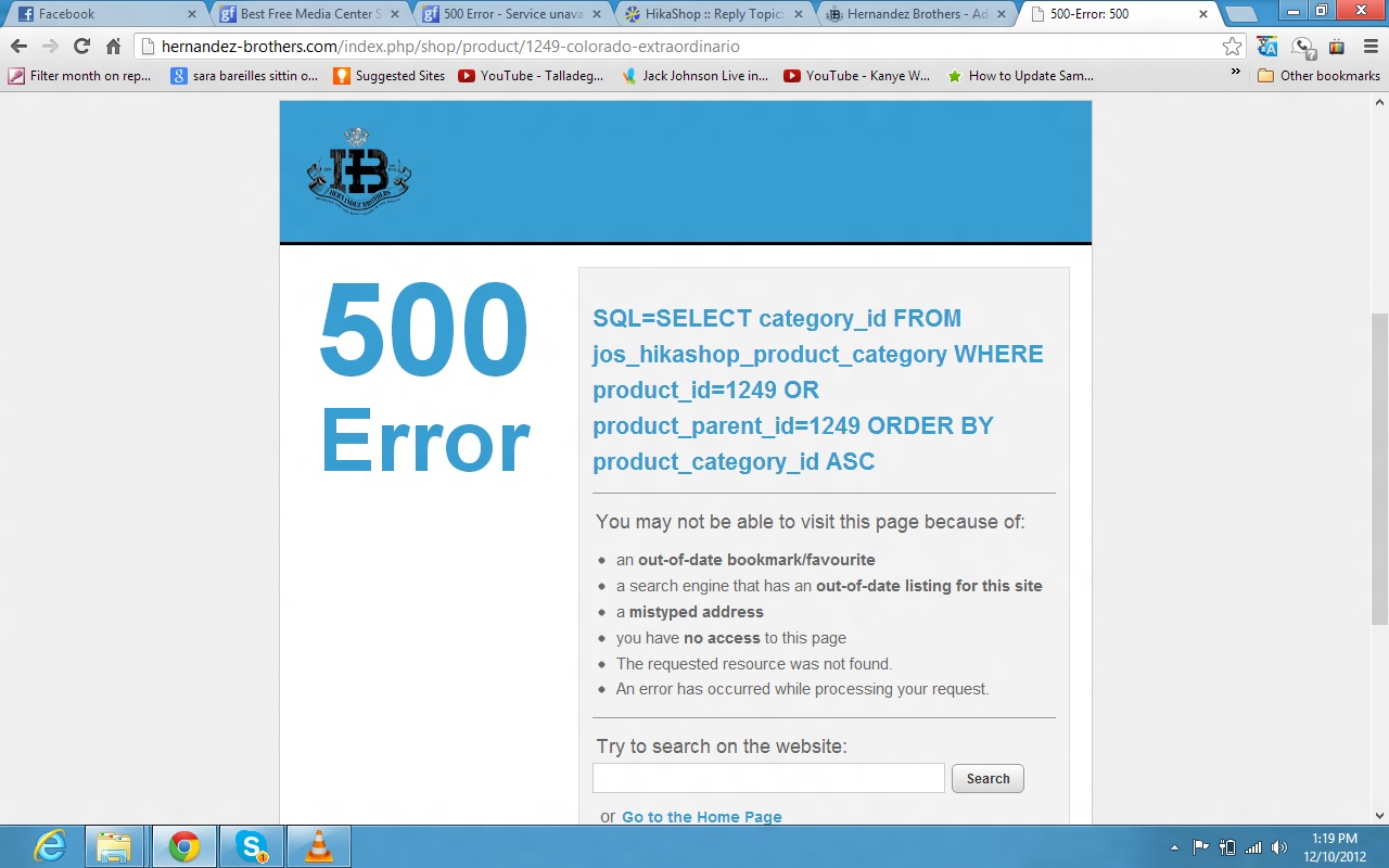

I have uploaded products to Hikashop. When I go to the front end and click on a product I get the following error. I can click add to cart and complete the checkout process. I am unsure what to do to fix this. Thanks in advance.
SQL=SELECT category_id FROM jos_hikashop_product_category WHERE product_id=1249 OR product_parent_id=1249 ORDER BY product_category_id ASC

Can you give us a link to your website, or a screenshot of the error ?
Have you enable the debug mode of Joomla ?

The website is Hernandez-Brothers.com. I have turned on debug mode and attached a screenshot.
11 years 11 months ago #81337
Do you have the latest version from our website ?
This kind of errors without informations come from Joomla 3.0
Can you try to enter the sql request in your phpMyAdmin ? to see if any result is returned ?

Yes I have the latest version 2.0.0. Yes I am running Joomla 3.0. This is my first time using Hikashop or any shopping cart. I am not sure how to run the sql statement. I will do some research and try to figure out how.

Nicolas submit a patch this morning and I think that you have the same problem.
I have update the package so, please redownload HikaShop 2.0

Everything works now thanks
