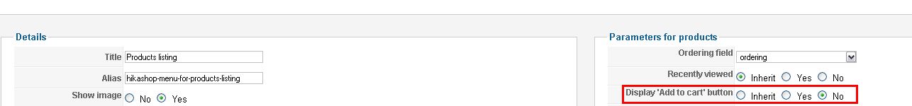

Even though in my product listing menu I have disabled the "add to cart" option, it is still showing.
It is disabled in all other views as configured.
Is there a workout around for this?
Here is a link showing the add to cart buttons:
bowlforcash.com/balls-for-sale/category/13-used-balls
I will attach an image showing the option turned off.

The problem is that you are not editing the good menu.
I think that you have created another menu/module to display the balls for sale.
Try to edit the options of the other menus/modules.
To remove the "each" you can do it in the language file (HikaShop > Configuration > Languages) and seach for "each" and remove the text, just let the empty quote "".

I'm not sure I fully understand. This only happens when I am using a product category as my menu type and then click on a category listing.
I changed to a product listing, selected to remove "add to cart" button and it was removed.

I understand now. I had created a menu that was tied to my main menu and it was a menu type "product categories" instead of using the already created product categories menu that is created with hikashop by default, correct?

Yes, if you are using another menu so, the used option would be on that other menu.
