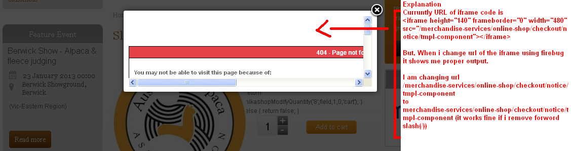

Let me explain visually.
Here i attached image. kindly check that image.
