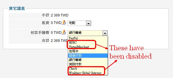

Hi there,
In the order detail page of a certian order, there is a section called "Other info" (Translated from tranditional chinese).
I found the in the dropdown select list of shipping and payment method, there are options which have been disabled.
Such as:
I realized these options just appeared after I clicked into the corresponding shipping and payment methods.
However, I didn't enabled them.
I wonder why they still appear in the shipping and payment method value of the order detail page?
Is it a bug or I just missed anything?
The relative code is:

11 years 11 months ago #83005
It's not a bug. It's to allow you to set payment methods to orders without the users being able to select them on the checkout. If you saved once a payment method options, the payment method will display there so that you can select it.

11 years 11 months ago #83063
Dear J.,
Thanks for the explanation. :)
However, for my case, I have uninstalled the HSBC and VirtualMerchant through "Extension Manager".
The respective options can still be selected?
Thank you for checking. :)

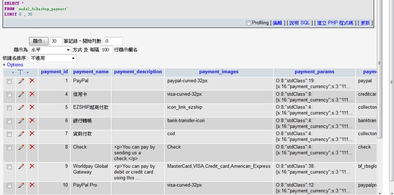

11 years 11 months ago #83086
The options are stocked in database, check in you phpMyAdmin interface if you have these payment methods in the table "#__hikashop_payment".
If they are present, try to remove them.

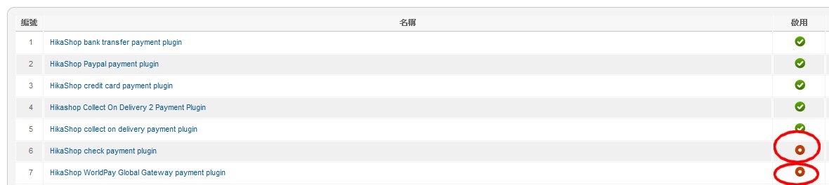

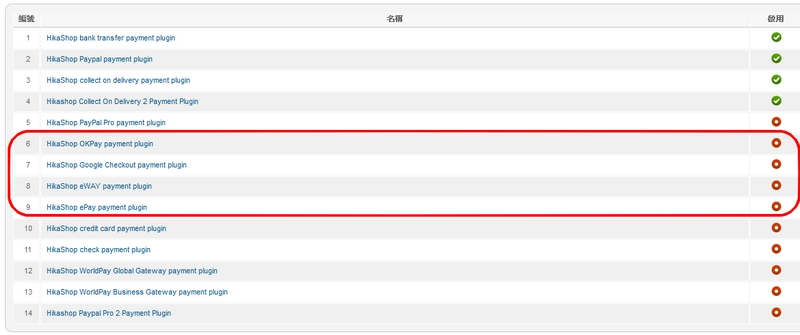

11 years 10 months ago #85550
HI there,
I checked the #_hikashop_payment table in Database, and there are only 10 methods.
But in the back end, I see there are still 14 method, where the circled 4 methods were already removed before.
I hope to remove the 4 uninstalled methods in the payment method control panel of hikashop (otherwise, it will be inconsistent.). What should I do?
Thank you so much. :)
Last edit: 11 years 10 months ago by tinachou.
  • Posts: 26158
  • Thank you received: 4028
11 years 10 months ago #85680
HikaShop store a line in the database only when you edit a plugin configuration.
After that, I don't understand your message. Why you don't use the patch that I gave you two weeks ago ?
  • Posts: 107
11 years 10 months ago #85729
Hi J.,
I have used your patch. It works. :) Thank you very much. :) :) :)
(I think the patch your provided is only for correcting the payment selecting list in Order detail.)
The problem now is that in the hikashop payment plugin panel, there are 4 uninstalled payment plugins. According to Xavier's previous reply, they may be stuck in the database so they are still existing in the panel... ( For general logic, the plugin shouldn't exist as an option in the payment plugin panel after it is uninstalled, right? )
However, when I go to the Table #_hikashop_payment,I cannot find them. My question is how to "NOT Display" those uninstalled plugins?
  • Posts: 82863
  • Thank you received: 13372
11 years 10 months ago #85763
The options of the plugin stays in the database even if you delete the plugin because then, when you reinstall the plugin, you get the options back. You wouldn't believe the number of people uninstalling something they should not have... then, if we remove the options on uninstall, they would have lost their settings and they are not always the ones configuring HikaShop in the first place...
A plugin which is both uninstall in Joomla and not in the payment table of HikaShop won't display since there is no data about it anymore anywhere. You must have missed something. Maybe you didn't delete the correct plugin ?
