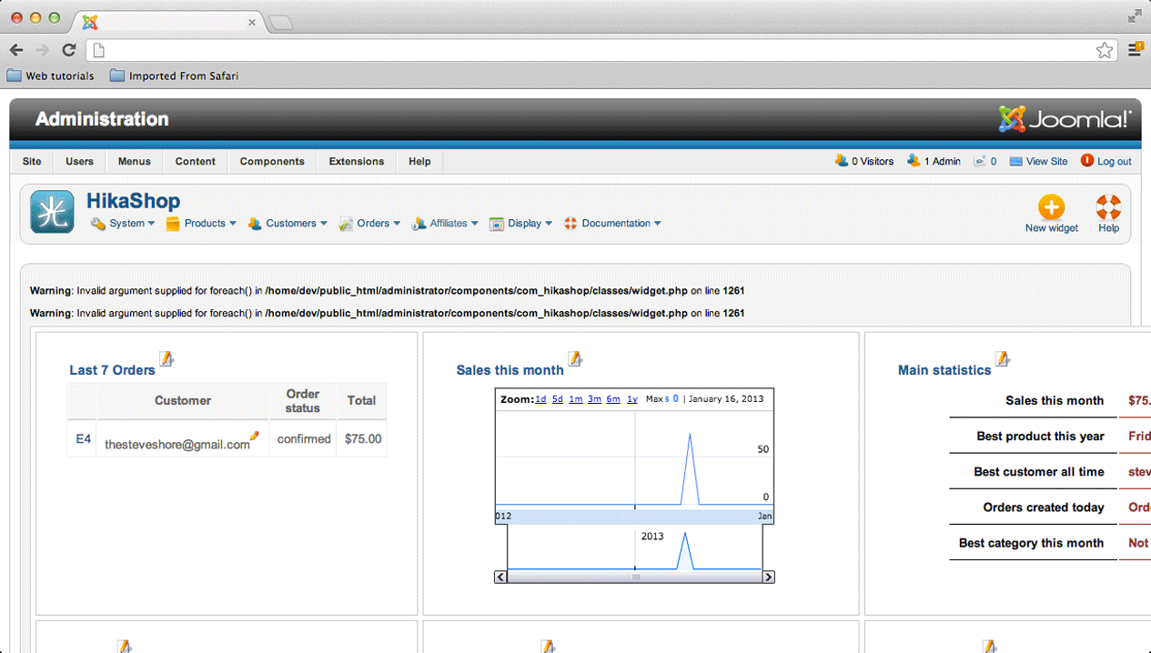

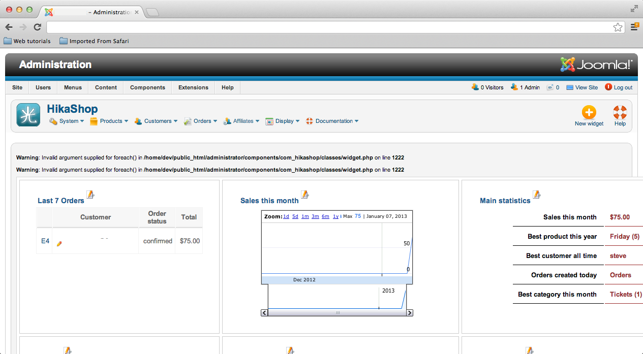

I tried to run a report to see all the customers that purchased a certain product and got this error. Now it is displaying everywhere.
Warning: Invalid argument supplied for foreach() in /home/dev/public_html/administrator/components/com_hikashop/classes/widget.php on line 1222
How can I fix this?

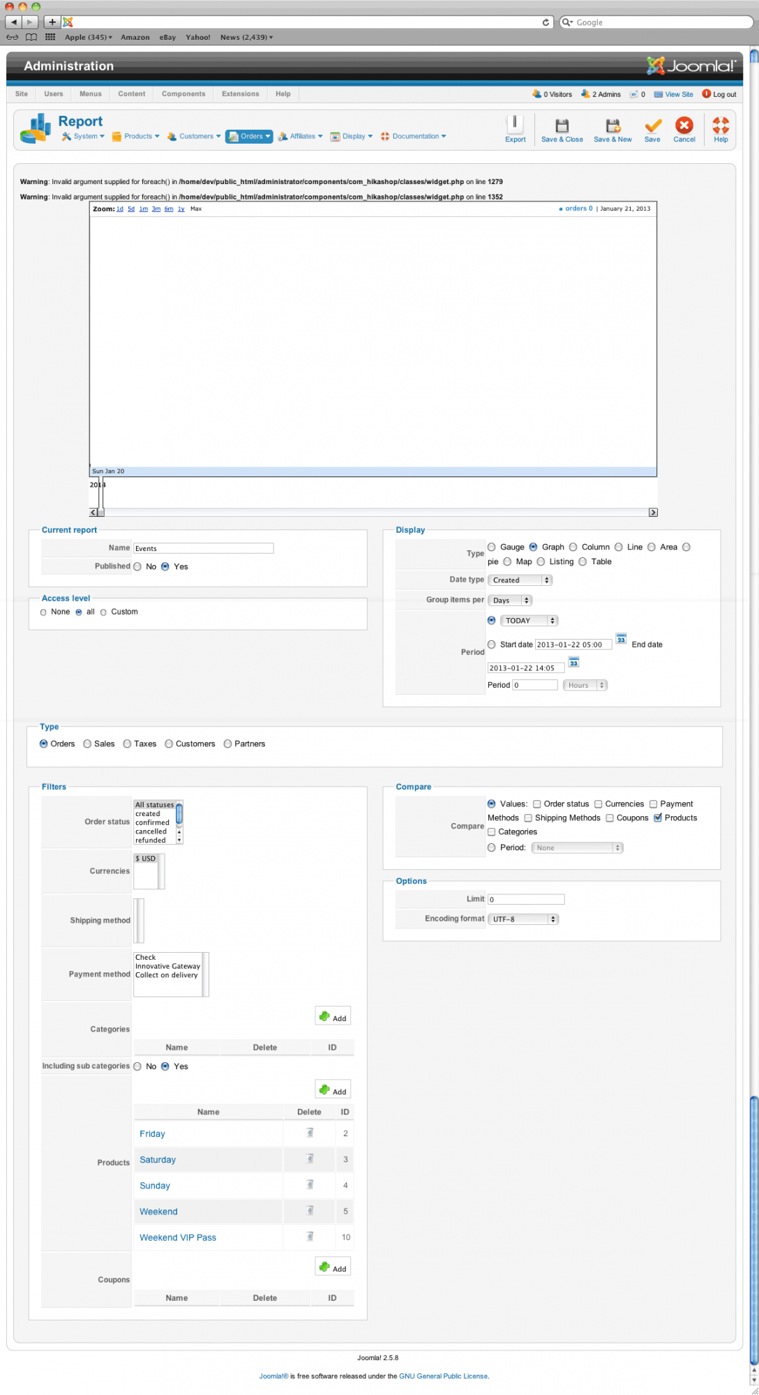

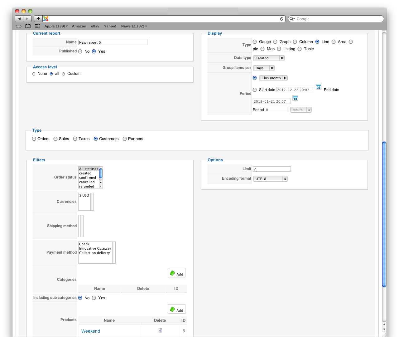

Okay I understand now. I was a little confused about what a widget was. The errors are both coming from custom reports I created. Here are the settings:

11 years 10 months ago #86510
Indeed it's a small bug. You have to edit the file widget.php in administrator/components/com_hikashop/classes and replace these lines:
foreach($elements as $element){
						if(!isset($typeTable[$element->type])){
							$typeTable[$element->type]=$element->type;
by these:
if(!empty($elements)){
By the way, filtering by product on that kind of report is useless since the line of customers just show the number of new customers. Those who just registered.
So filter by product is meaningless.

Getting error on another page now. It is custom as well.
